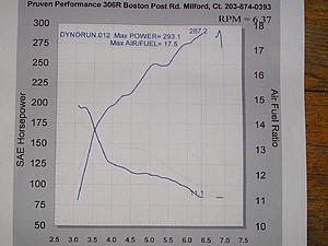

Got Dynoed Today
I went to Pruven Performance today.
the numbers i got was much better than i thought.
the mods installed are:
rmr intake, buschur3" turbo back, blitz bc id, safc and greddy type s

what are you boosting, what octane also??

oh yea.. sorry..
93 mobil and 19.5psi

man....you are running a lot leaner than stock, 11:1 at 6500?

yeah and at 11.7 i run at 282.8whp at 6.5k rpm

i need 6.9whp more to have 300whp

That Hp looks good, and just about right for the mods you have. Can we see the torque curve? I am no expert on this engine, but I would consider adding a little more fuel in the lower RPM's (were the torque peaks) and maybe go 11.5 from 6-7K?. Tweak the boost up just a hair, or wait for a cooler day and you will probably see 300WHP easy.
There is a guy down here with similiar mods plus hks cams, 22 PSI (maxing the turbo out so it tapers 19PSI), A/F 11.5, he is showing 325WHP on a 100+ degree day. He's been out road racing it (just beating the **** out of it) on these 100 plus degree
days. I am not recommending this, but it does seem to be taking it well, for now.
Thanks for sharing

nothing a little race gas wont fix.. thanx for your info.. im goin to try that.. my next mods are hks cams and a bigger front mount.. im probably gonna get the pruven fmi b/c i seen them today and they looked mean on the car

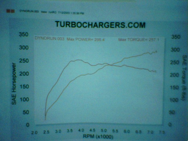

Dyno'd on 19psi and pump gas. I have a 3" Mandrel bent Turbo back exhaust that I tig-welded my self. (Cost was 150 bucks for the bends and Magnaflow muffler), SAFC (270 bucks on a group buy), AVCR that I had from my last car, and Blitz B.O.V (vta) and hyper ground kit (also self made). FYI I run mid 12's all day long and have spent around 500bucks in mods on my car and did all the installs myself.

Wow badassCR! I think you deserve an award for the most hp and the least amount of money!! Are you running 20 PSI, or are you pretty lean up top?

BadazzCR- Good work!! I agree that your power to dollars spent ratio has to be one of the best out there, plus the satisfaction of knowing you did it yourself is icing on the cake!
