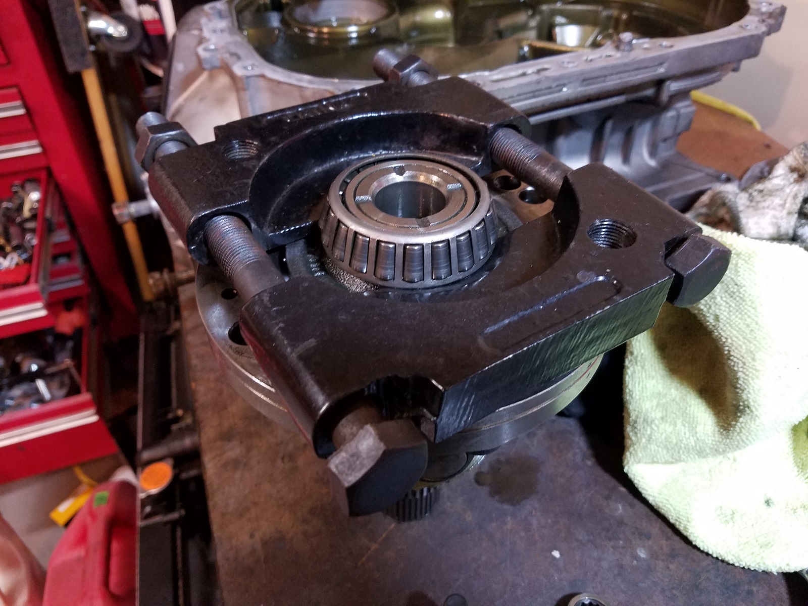

So my bearing splitter worked great for everything except the center diff top bearing. It's to small (diff same size as splitter).
I'm using the large splitter from Harbor Freight, does anyone have any other economical suggestions?
I'm trying to avoid cutting it off, but will if I have to

I cut mine off. I also could get a bearing splitter to work.
Yeah, I'm leaning towards cutting it off because I cannot find a big enough splitter locally, and the extra large splitters on Amazon are over $150...
Where did you get your splitter, is it a 6-8" splitter?
Sometimes the bearing is easy to remove, try to grip the bottom of the rollers. If that doesn't work, remove the bearing rollers and retainer, and try to grip the inner race by the upper lip. If that doesn't work you'll have to cut it off.
Idk, its what my dad has in the shop. I had a typo, I couldn't* get one that worked...lol
If you can pull a bearing off by hand, the diff housing is bad.
I tried putting the bearing puller/splitter around the upper lip, the lip just broke off..
Roger that, I'll just cut it off carefully.

If you cut most of the way through, you can crack it with a good cold chisel and solid hammer. That's what I did. That way you don't have to worry about cutting into the diff housing.
