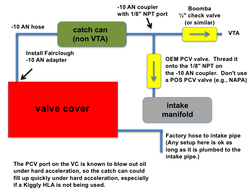

Are you using the factory or aftermarket check valve? Aftermarket valves often have much too high of a flow rate to be correctable by closing down the BISS. If you want to use the IM for PCV and get the benefit of using the PCV passage on the valve cover to reduce crankcase pressure, then the arrangement in my drawing below is needed.

Yep, I'm sure that a BISS adjust will get the job done with some setups. What check valve are you using? While I didn't mention it in my prior post, the layout that I show allows for maximum benefit of using the PCV port on the VC to provide crankcase pressure relief while allowing idle to function normally.
A large one from McMaster Carr. I was running all 10an lines, which proved not controllable. So, I replaced one section with 6an. Fixed.
Thanks Mychailo! I'll definitely keep this routing in mind. I already have the BISS turned down most of the way, so I'm thinking it definitely needs the PCV valve put back in along with some other tweaks perhaps. I'm planning on working on it tomorrow so I'll let you know if I manage to get things corrected and what I end up with.

From: IL
Well it looks like I got at least half of my problem solved over the weekend. On Saturday, I put a PCV valve in-line with the check running from the catch can to the intake manifold and that solved the high idle problem. I need to put some miles on it now to make sure it's no longer pushing oil past the turbo seals, but I'm hopeful that issue is solved now as well because before it used to smoke a little at idle and it doesn't appear to be doing that anymore.
P.S. I wish I could do cool diagrams like MRFred Lol!
