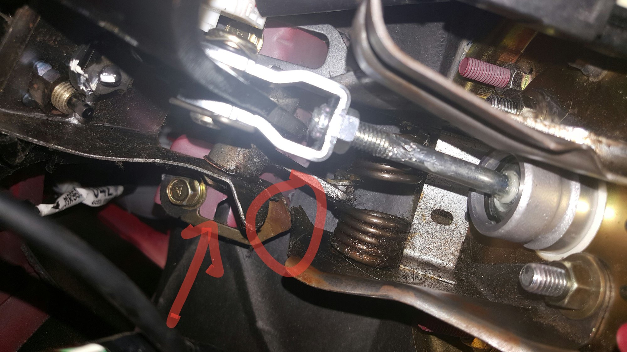

So upon doing a visual inspection, I found this. The clutch pedal bracket is broken and the actual chassis mount is broken as well. I feel like this very well may be my problem. I always thought my pedal seemed kind of weird and crooked. No telling how much free play that is causing before actual engagement.
Old Oct 15, 2016 | 08:24 PM
LetsGetThisDone's Avatar
Joined: Oct 2013
Posts: 15,973
Likes: 1,629
That'll do it

I had a buddy come out and weld the chassis mount for me. Bought a new clutch pedal and got the car put back together. I am happy to report that my clutch dragging is gone. So just FYI to everyone, always do a thorough visual inspection before making any big decisions.
