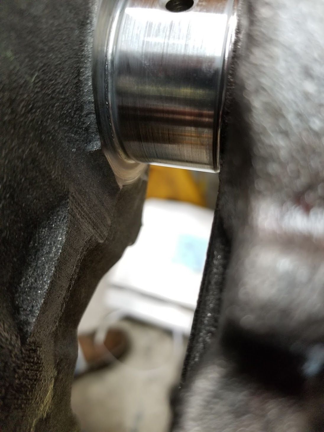

Thought I'd add more data about cracked cranks
This came out of a 2.4 build that I put about 80k on (My daily Driver) The block/crank came out of a crashed Galant
OEM 7Bolt 4g64 crank
Wiseco 1400HD K626M865
Eagle 150mm (Std Length) Rods
all balanced
No Balance shafts
OEM 2.0 Damper
ACT XTSS
At the time my car was powered by a BB FPBlack
624/525 on e85
524/427 on 92
Rev Limit set to 7800
I finally swapped engines due to horrible leakdown numbers and replaced it with a long rod version of the same engine.
A couple weeks ago I decided to tear down the 80k block and freshen it up! During the cleaning process I found the below crack on #4 (clutch to the left)

That's quite odd. Half of the point of an undercut radius is to keep it from cracking there.

I think a heavier flywheel will help reduce the stress in crank #4 journal.

I think you got your money’s worth out of that crank. Stock cranks flex some at those levels so they have a somewhat of a service life.
