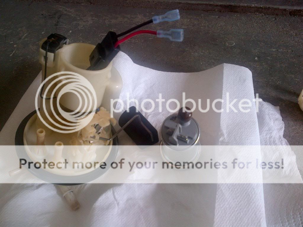

So I purchased a gasoline one off another member on here, and the connector that came with the pump seems to fit the one on the housing perfectly. granted it may have 0.5-1.0mm worth of play/wiggle but I suppose that's acceptable?
Also, the pump didn't come with the same connector the OP of this thread is showing, see below for a comparison;
*op's Pic
**my setup
Old Jul 21, 2013 | 02:44 PM
  #41
detroit pistins's Avatar
iTrader: (102)
Joined: Aug 2007
Posts: 2,173
Likes: 19
From: Detroit
update:
I am running into a fitment issue with the gasoline version due to its output nozzle being shorter. So it can't reach into the black grommet. Anyone else have experienced this?
see pics below;
Old Jul 21, 2013 | 03:41 PM
  #42
evoiao's Avatar
Joined: Dec 2009
Posts: 368
From: Ca.
you'll need to dremel the upper edge to get the pump to set down low enough to get the end cap on.
too me about 20 min and I was going slow.
so on you pic the edge that's hitting the housing, grind that down to just before the upper hook that holds the end cap in place and widen it out alittle as well.
there's another thread that shows how to do this with pics.
I also have a full blown dual fuel pump anodized purple so that it will not pit inside a tank of e85, includes two new pumps and new an fittings (that were an additional $125.00 and plus two new walbros 255s90.00 each) for $450.00 plus paypal and shipping. save over $100.00

the op cut his all the way down to the first clip you pic shows like you still have some more to cut off the housing. than you'll get that extra 10 mm your looking for.
