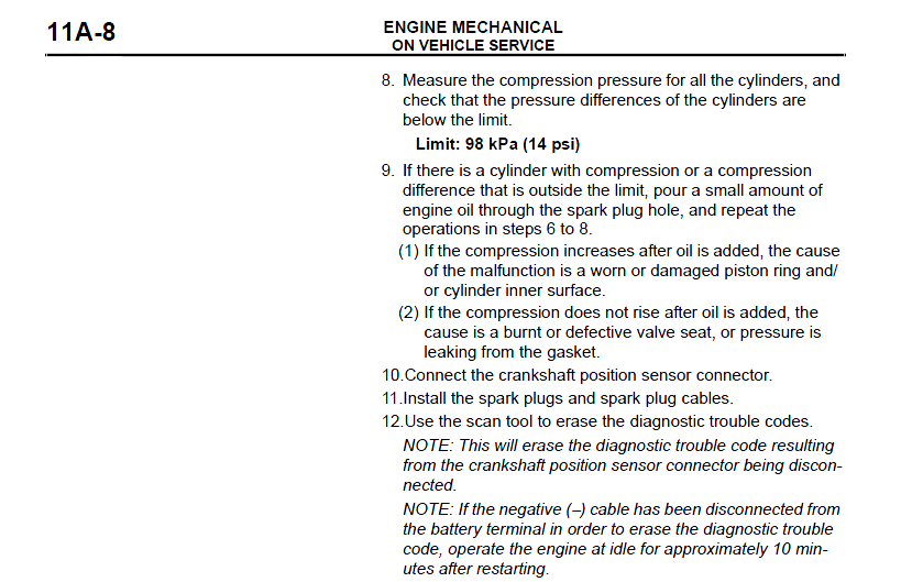

haha...ok so i did the compression test and they are sitting at 135, i think they are meant to be at 150 but i have 96000 miles so i think its alright.
Attached Thumbnails 03 lancer es Evo 8 build-4489_516315110219_199802623_30752598_5922157_n.jpg   03 lancer es Evo 8 build-n199802623_30752596_4542351.jpg   03 lancer es Evo 8 build-n199802623_30752597_3675149.jpg

Standard value is 234psi and the minimum limit is 170psi. Here is how to test compression according to the FSM:
Attached Thumbnails 03 lancer es Evo 8 build-compression.check.1.jpg   03 lancer es Evo 8 build-compression.check.2.png

ughh i didnt do any of that lol, i didnt unplug the sensor or remove all the plugs or push the gas pedal down. i guess thats gonna make a big difference right lol
If you don't unplug the crankshaft position sensor the injectors will be spitting fuel into the cylinders. You also don't have to hold down the gas pedal, you can just stick the handle end of a screwdriver into the throttle body to hold the plate open.
