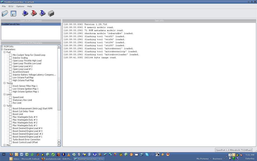

Ok guys, good news! I got a hold of a stock fuel rail and installed it this morning. The car runs WAY BETTER NOW! This solved my super low AFRs (very very rich) and increased performance/power considerably. Let me explain: I got the bored fuel rail when I was N/A to help with throttle responce by ensuring there was enough fuel behind the injectors when I'd mash the gas. It worked great for me as N/A. However, when I went turbo, I also added a much larger fuel pump (Walbro 255) and a 12:1 FMU (for every 1 PSI of boost, fuel pressure is raised 12 PSI). So basically, I was flooding way too much gas into the engine. When RRM built this kit, the fuel solution relied on the stock fuel rail. So now after installing the stock FR back in, my AFRs are around 11.1 at WOT which is a great improvement over the <10 I was reading before hand.
However, even though the car is running much better, it's still too rich. AFRs should be tuned to around 11.5-12 for turbo guys and 13-13.5 for N/A guys. So on Monday I'll start tinkering around with the ROM and see if I can't get a good tune. I'm still trying to find the best way to log my wideband (AEM UEGO).
Glad to see more people getting the cables and getting ready to flash!
It should something like this: (this is the screenshot of an EVO8 ROM loaded in ECUFlash). Note how all those parameters/maps on the left column can be selected.
