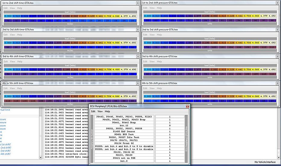

Old May 1, 2010 | 02:34 PM
  #168
4g94T's Avatar
Posts: 2,069
From: California
Here are the maps
Attached Thumbnails Confirmed:  Evo ROM Can Be Flashed to Lancer ECU-map.jpg

Originally Posted by 4g94T
Is there a way to log TPS voltage?
If you mean the value that map is using not at the moment but i can give you instructions to get values of X from the computer . TPS position should be enough to log at this time but there is another variable which i'm highly curious about.

I tested out the maps.
I set all the shift times to 28 and shift pressure to 111 just to try it out.
Just driving normal it shifts fast and hard, sounds like the EVO X
