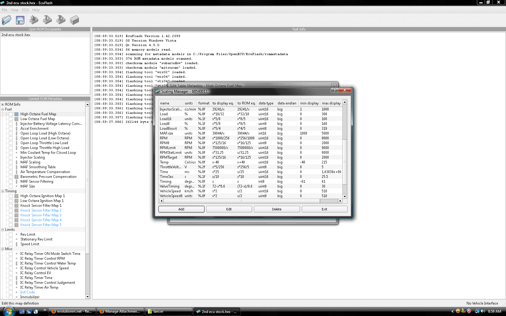

ok so i change the memmodel and added the new xml and when to pull the rom off my car and still no go say i need a def files still, and when i read an old rom with the change def file it makes my rpm and loads our of wack and now the auto option arent greyed but they all show 0 or everything
as for the rpms and load, make sure your endians are set to big:
EDIT:for some reason, its working on my laptop but not on my desktop..? wierd
i even reinstalled ecuflash 6 times...
Attached Thumbnails Confirmed:  Evo ROM Can Be Flashed to Lancer ECU-untitled.gif
Try inheriting from your old xml file if you can then close out ecuflash and see if it created the file. My desktop was being *****y too :P
