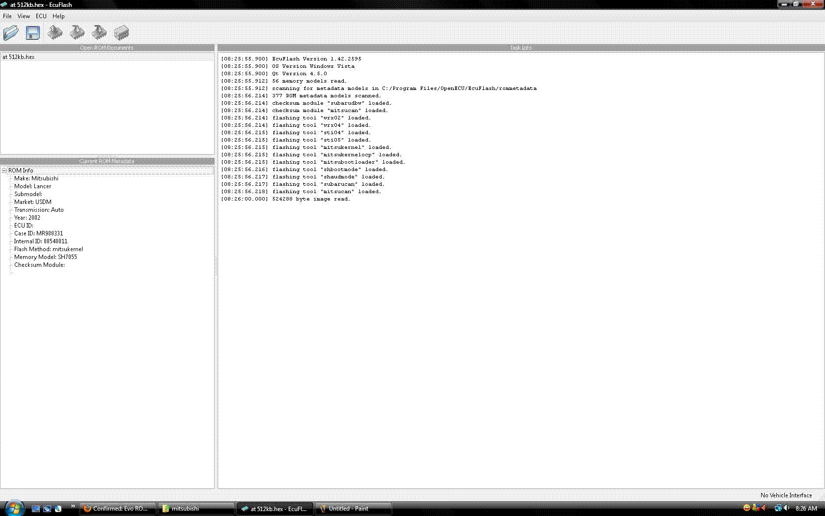

Old Apr 29, 2010 | 08:21 AM
  #100
ClixT's Avatar
Joined: Jul 2008
Posts: 479
From: Lake Forest, California
Originally Posted by RoadSpike
You do realize when i said the auto transmission variables are in the later 256kb of the rom you have to use the 512kb version right?
i do but if your gonna open the 512kb rom, you need to define it.
i tried to inherit it with the 88540011 but theres no tables..
sorry man.. idk if im just being stupid..
i think we need a whole new def for this rom since its twice the size of the old one..
Attached Thumbnails Confirmed:  Evo ROM Can Be Flashed to Lancer ECU-untitled.gif
Old Apr 29, 2010 | 09:08 AM
  #101
RoadSpike's Avatar
Joined: Oct 2006
Posts: 3,805
From: Sacramento, CA
Yeah the xml file i posted should have opened it for you with all your tables intact.
Old Apr 29, 2010 | 09:25 AM
  #102
ClixT's Avatar
Joined: Jul 2008
Posts: 479
imma reinstall ecuflash..
Old Apr 29, 2010 | 09:53 AM
  #103
ClixT's Avatar
Joined: Jul 2008
Posts: 479
SUCCESS!!
reinstalled ecuflash and its there.
man ur awesome!!
