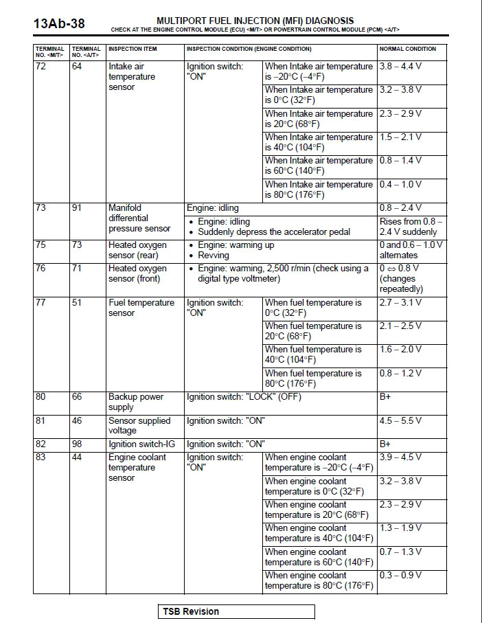

Originally Posted by link62
when you click on the file names look at the last digits for 13ab i cant tell u the begging cause i just organized them all today
when opened it will say multiport fuel injection (mfi) diagnosis
Awesome i found it now
I'm going to disassemble the auto tranny rom and see if the code appears for the AT control in the evo and how to get it enabled.

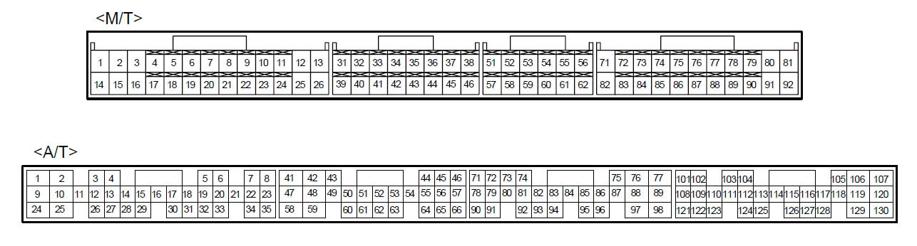

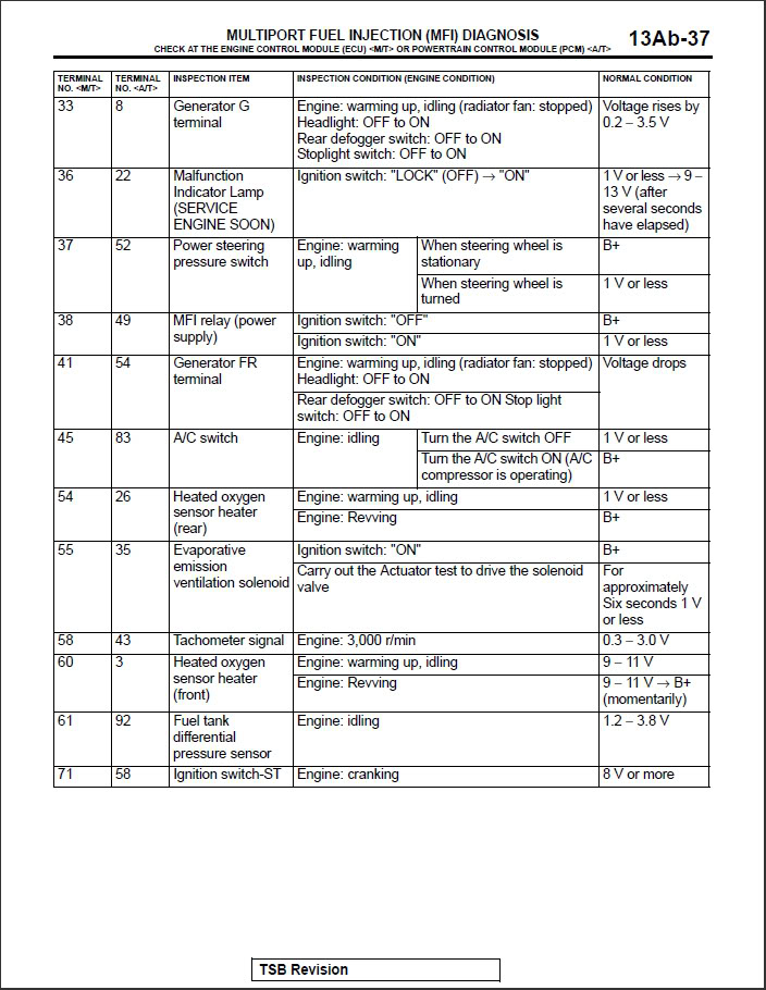

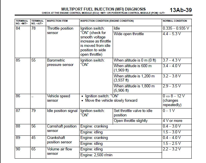

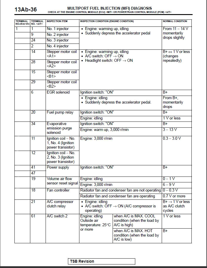

time to share these:
dont mind the small Evo VIII text. it should be M/T

the manual evo uses a completely different pinout and connector numbers then the lancer auto, , the gta uses almost the same as the manual evo , if someone has a copy of that pinout I think thats the key to this ,
Someone would have to disable the extra one gear in the wagon rom and I think it'd work
here:
credit goes to nads1978
