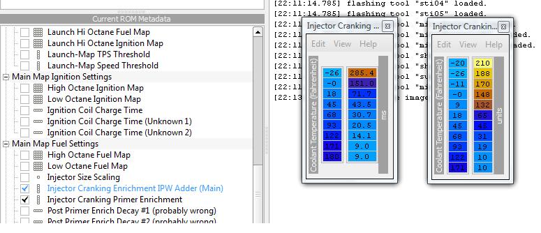

so i guess i can say the codes are not gonna come back at all and i think i know why my start ups are taking forever, i looked at a few logs that i did and i see at start up that my timing advance is at 61 for 3 sec before the car wants to come on at 125 rpms and slowly climb to 1k and have a normal timing so im not sure if thats the cause?

hmm that is pretty strange I'll ask tephra if he knows about any routines involved with startup that override the timing map

Hey link i took a log of my own car and it does the same thing with a known working tephra patch the start up problems have to be fuel related imho.

Link, you need to play with your injector cranking to fix start ups.
hmm ok RS lol i was hoping that was it
and 4g94t good to see you lol u just dissapeard on us and im not sure what to change and by how much?
It should be these two maps...
I remember on the GT-A rom I lowered the whole map by 10 units.
Lower the values only if the car requires you to push on the gas pedal for it to start.
The left map is in MS though, it is in different units compared to the GT-A rom.
Can you try and see if they make a difference when you change these values?
I tried and the car did not respond to any changes on start up.
