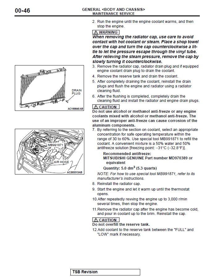

See attachement.

thanx blaze ,yea i got that in the manual i got but it says that there is a cylinder block drain plug but does'nt say exactly where that is.
It says "if equipped".
I don't think there's one. If there was one, I'm not even sure I'd use it. The rad drain plug works just fine
edit:
I just quickly went through the engine diagrams in the service manual and I couldn't find any drain plug.
