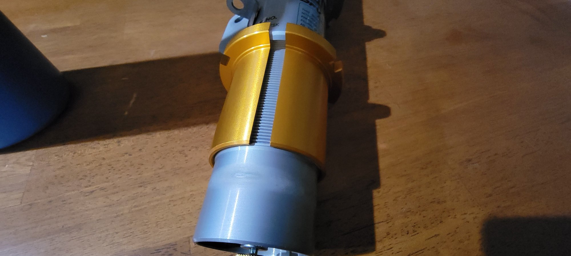

I didnt see any tab on mine to clock them. The height adjustment collar has a slit down the middle of it but thats all I remember seeing. I will be sure to check to see if there is a difference between the mounting location height from stock.
Ya last time I had the car on jack stands I was going to do the sway bar and then realized how much fun the undertray looked like to take off and said nope, I will do this on a lift. I am dreading doing the rear bar....
Not doing the SPL lower arms for now. I want to see how much camber the top hats get me. They claim 3° which will be fine for me.
Yea, the gold collar will probably be what clocks everything correctly in the hub mount. Also, I found it WAYYYY easier to get the OEM strut out of the hub mount by taking the whole assembly out of the car. Spreading that thing is a pain in the *** while mounted. (that's what she said)

if the gold collar is supposed to be what clocks it, then I can clock it however since it's threaded on the inside. When you say pull it off as an assembly, you mean pull the spindle from the arm?

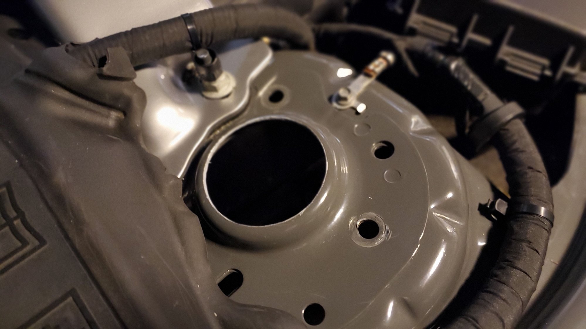

Here is what I am dealing with.

Originally Posted by razorlab
Since you have the adjuster on the bottom of your front coilovers, you won't have the issue that I had with the camber plates being limited by the top adjuster hitting the shock tower. So all good there..
Can you open up the tower like the mustang guys do? It was a slight pain in the ***, but not TOO bad.
Old Jun 2, 2022 | 08:23 PM
  #1522
Lumpy Sticks's Avatar
5 Year Member
Joined: Sep 2018
Posts: 1,703
Likes: 310
From: CA/AZ
It would be real easy to do but I'm not sure how much of the "webbing" would be safe to remove.

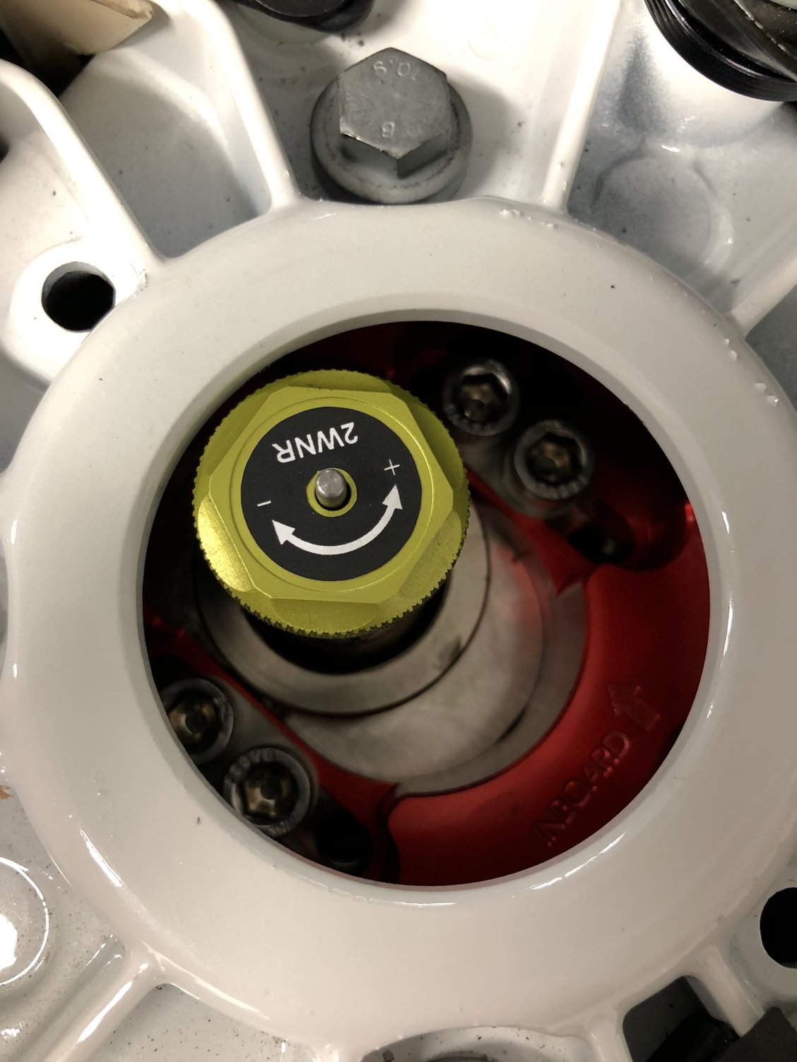

This is my clearance at the upper shock towers for the curious

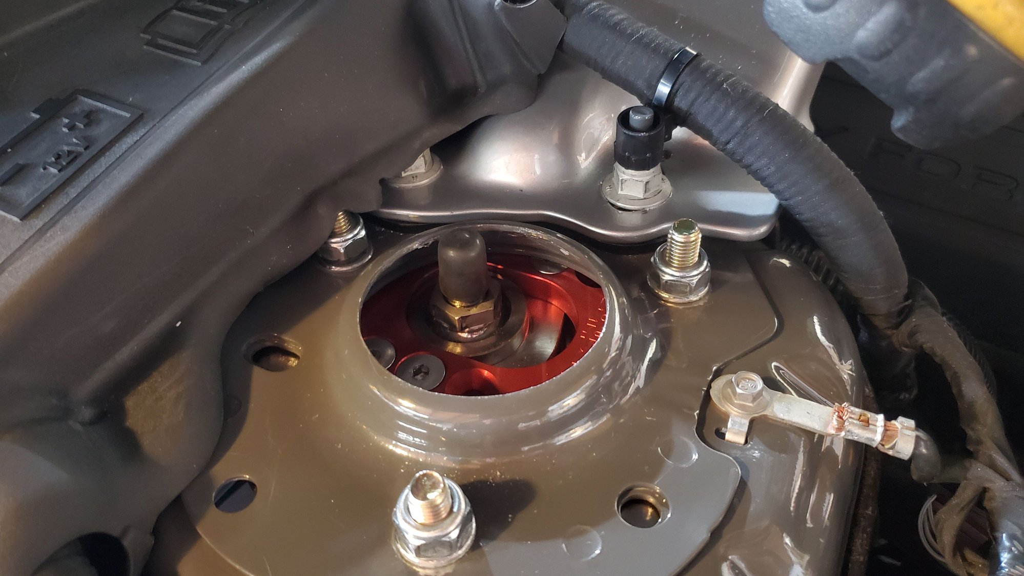

Here's how I did my car.... Aluminum may complicate things...?
