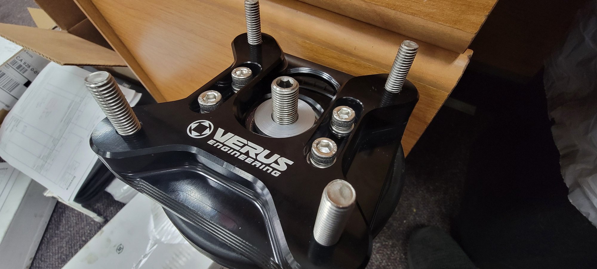

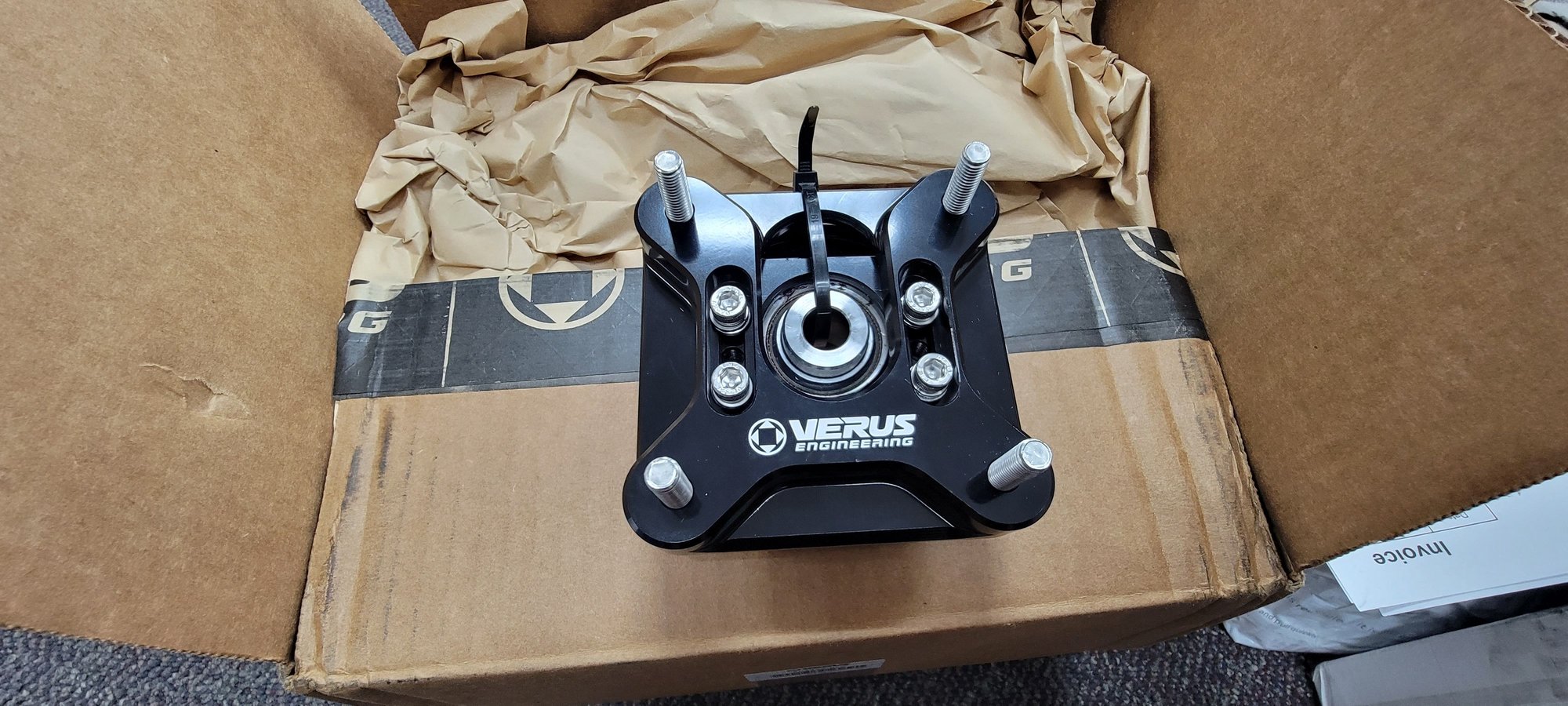

After opening the camber plates to test fit them, I read the description that has in bold "does not work with Ohlins"..... ya I missed that part. There go my weekend plans

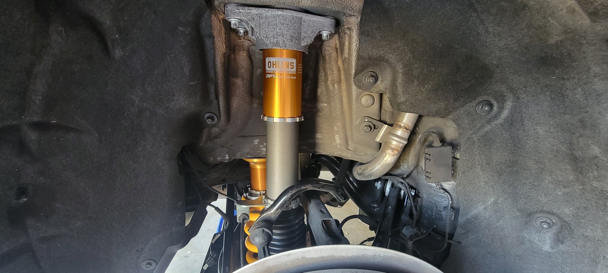

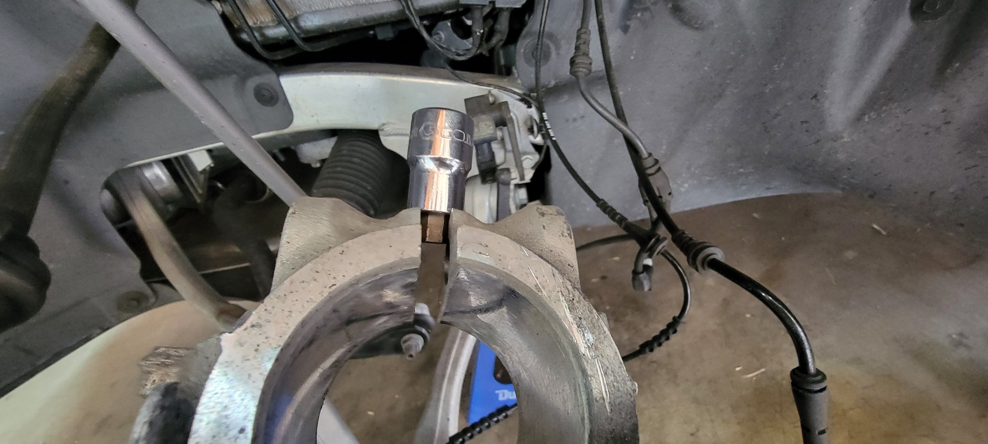

Ok perfect. That's exactly where I'm at. Tackling the front right now. Little tip for you for next time. Use a 7mm Allen to open up the strut clamp.
Tried that too. :P Trust me, the clamp was open, struts weren't having it. :P
Haha. Mine popped right out with the help of a pry bar. Hopefully the other side goes the same.

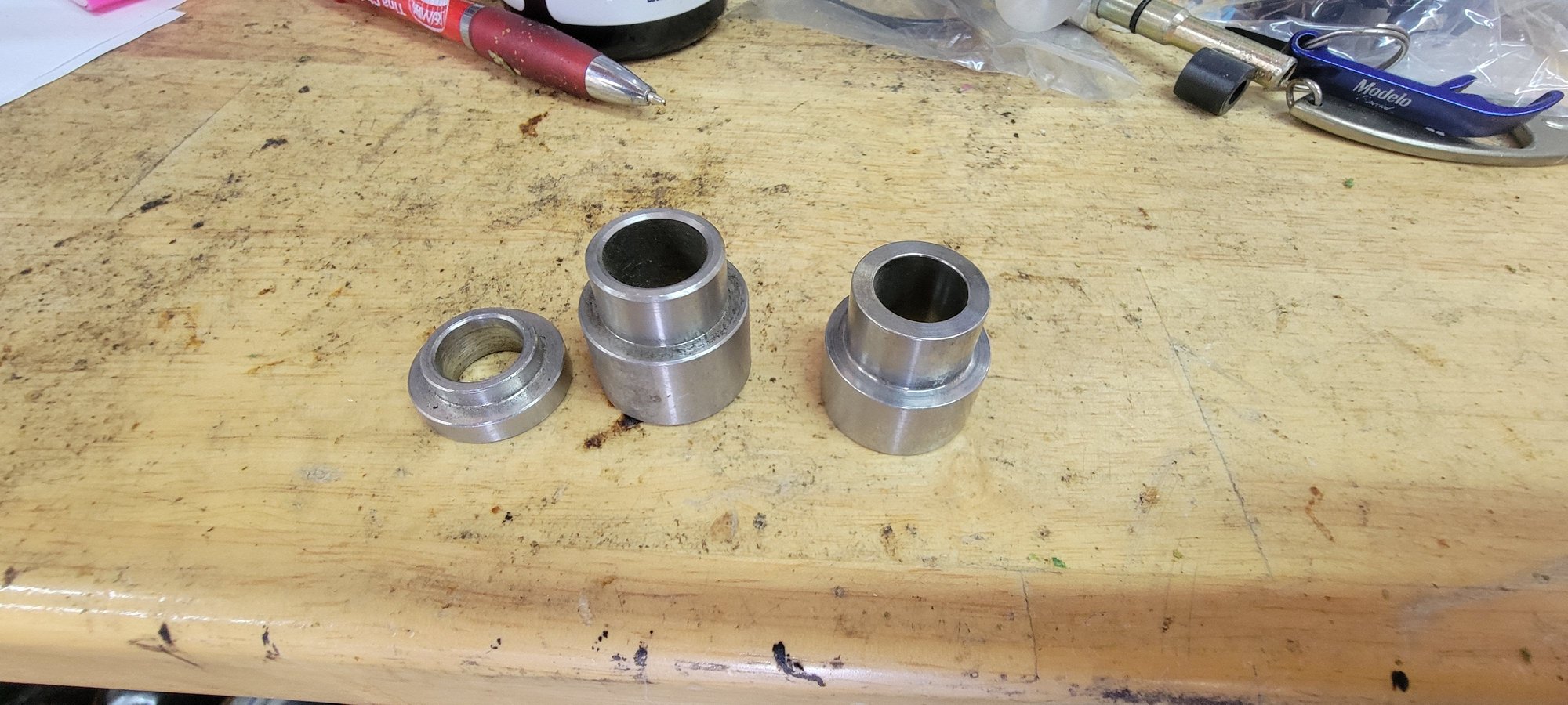

Ok I got my top hat situation figured out. As I mentioned above, the Verus top hats don't work with Ohlins. This is true, unless you have a machine shop and can make some very basic stepped washers. So tomorrow at work, I am going to make these stepped washers and I will be in business. Stupid that Verus won't make something like this and offer people with Ohlins the option to use their top hats.
The problem solver will look something like one of these.
Old Jun 5, 2022 | 05:08 PM

Originally Posted by SoSoEVO
Marcello to the rescue! LOL
You know it! Should have them ready to go here in a few hours. He has to write a program for the CNC lathe and then they will be made.

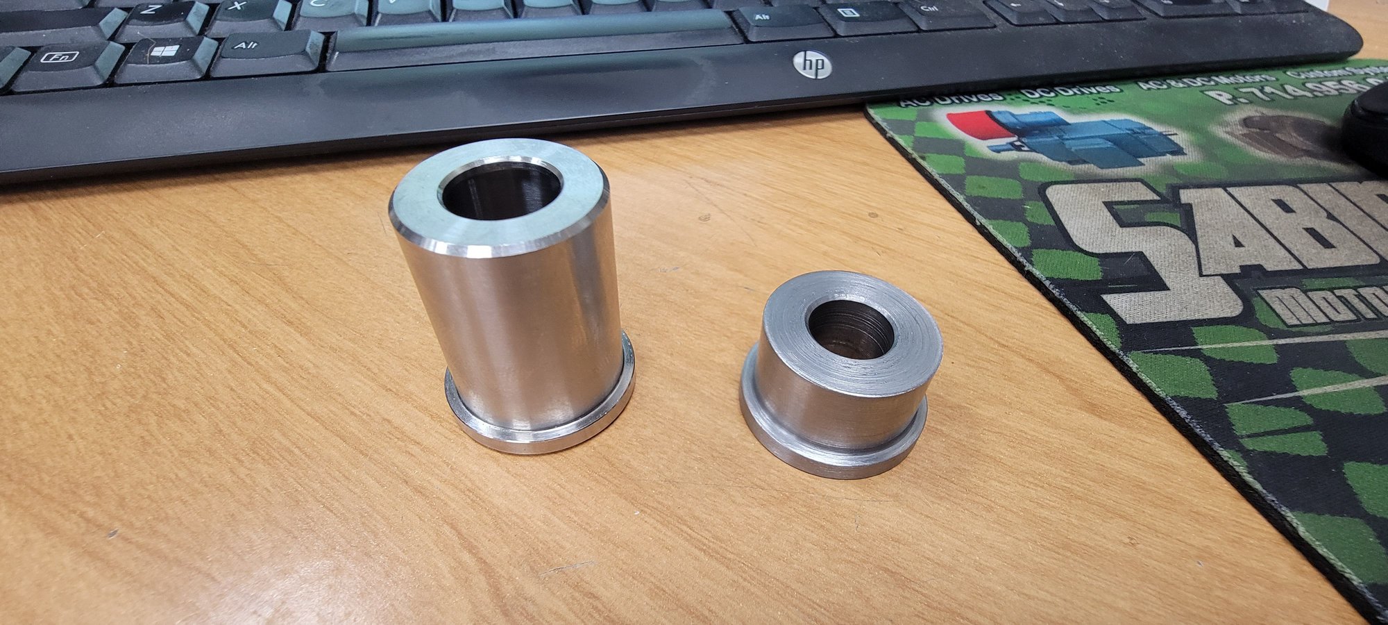

I get all my parts through my shop.
My coilover fix is done. Just 2 of these tiny little parts (left is what it came with, right is the problem solver) solved the issue. So sad.
