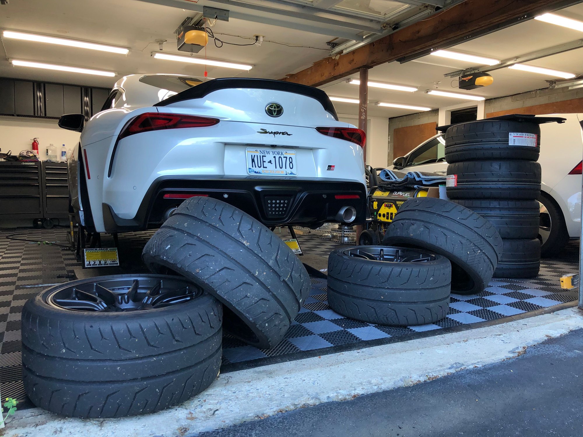

Conti Forces coming off tomorrow, CR-S going on.
Pocono this weekend.

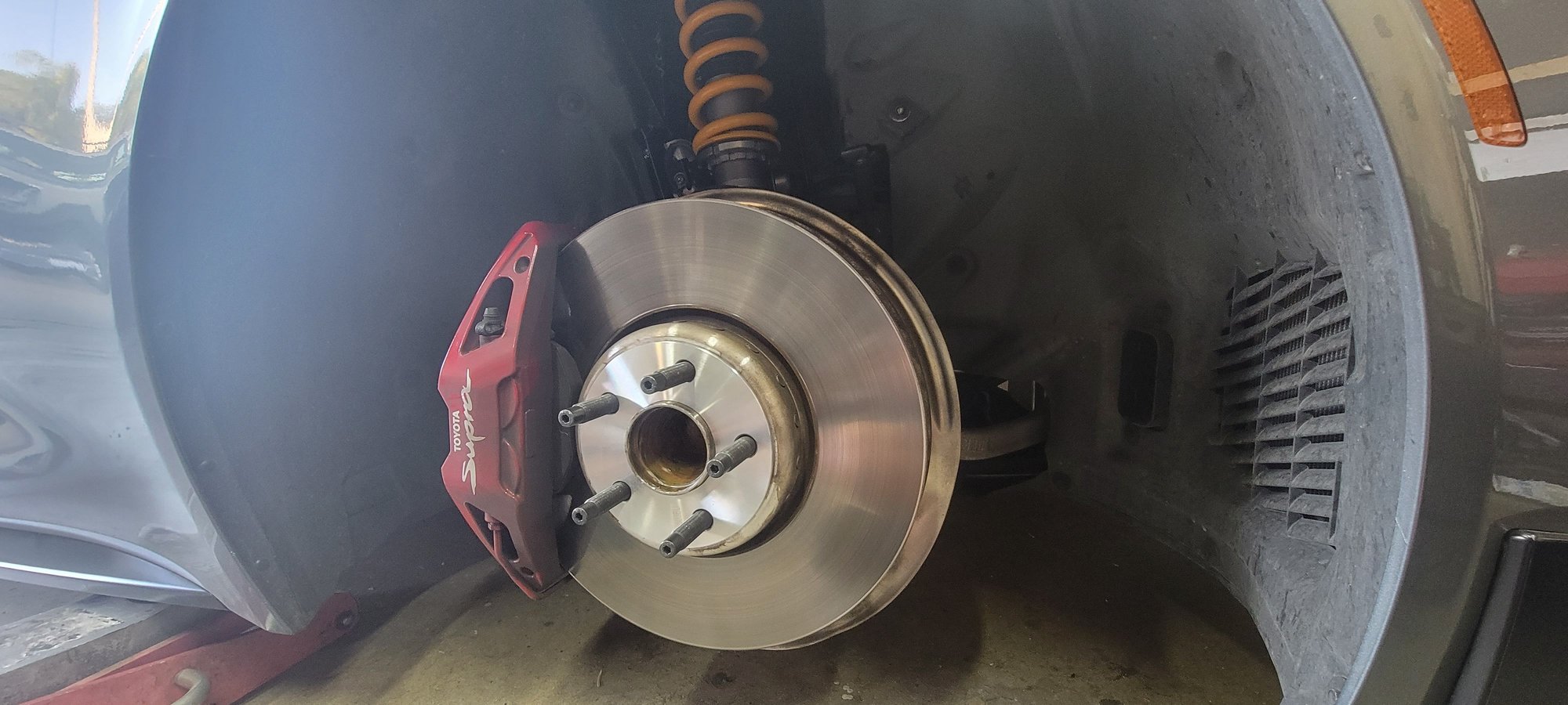

Ok so I have about 50 miles on the 315 square setup. Everything was super close to rubbing. Well it ended up being close enough to rub on hard turns. I knew this was going to happen so I ordered 3mm spacers and put them on tonight. Problem should be solved.

Look at those cute little spacers. haha

Hey hey hey. Don't hate on my spacers haha. 2mm probably would have worked but you know what they say, bigger is better!

Are those the front brakes? What size are they?

Yes front brakes.
Front and rear rotors are almost the same size on the Supra 3.0
Front: 348mm x 36mm
Rear: 345mm x 24mm

Got the Nankang CR-S mounted.
I'm going to have to get used to the much taller tire, def a different vibe. At least my speedo will be more accurate now, lol.

Looks meaty/race car. Perfect.
