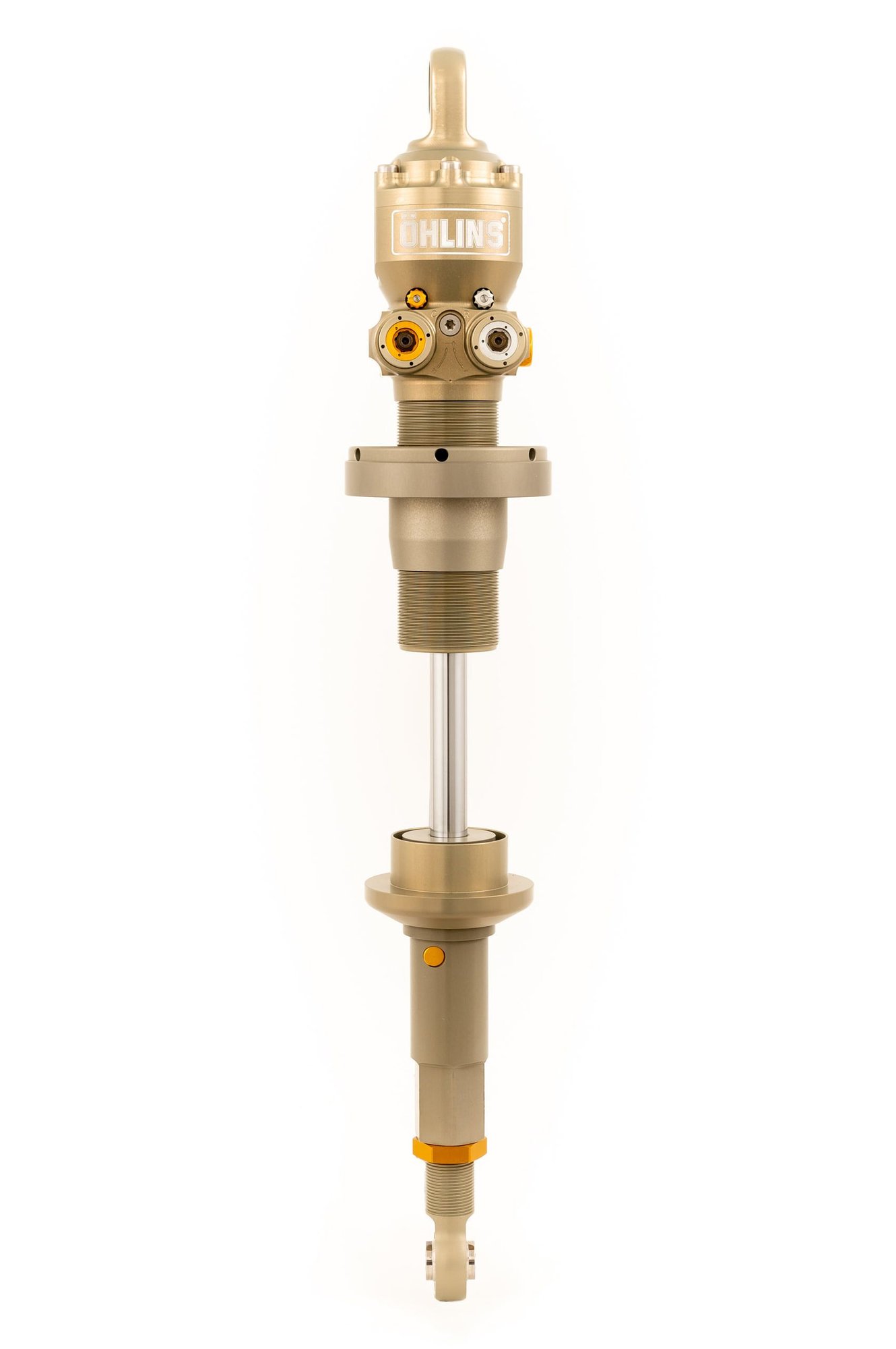

Ohlins and Nitron are the only ones that sell adjustable body length dampers... Ohlins did it specifically for their low cost (relatively speaking) line, not really sure why Nitron does it. Penske definitely only makes fixed length dampers. same with JRZ, Multimatic, Tractive, KW, Bilstein, etc. there might be a couple here and there, but most pro level shocks only make fixed length dampers.
This sure looks like an adjustable length Penske to me...

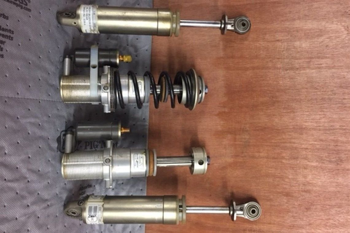

also here's a pic of F1 dampers that are definitely fixed length. adjustable spring perch, but not body length
and congrats, you found a weird penske application that has an adjustable mount... which by the way is done in a way not to compromise shock length (kinda like the 86 twins application I was talking about)

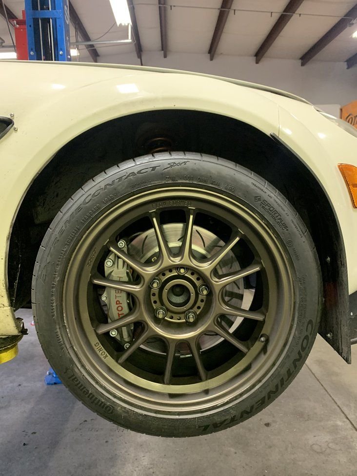

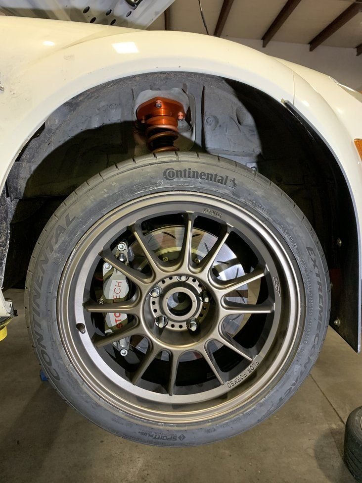

here's an example of travel:
Ohlins with adjustable body lenth:
and front and rear the compression travel is limited by the tire hitting the chassis. absolutely not the case for the rear with the Ohlins, and thats the case for lots of applications
