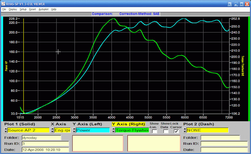

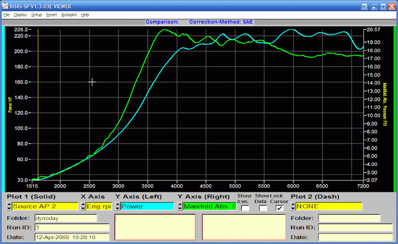

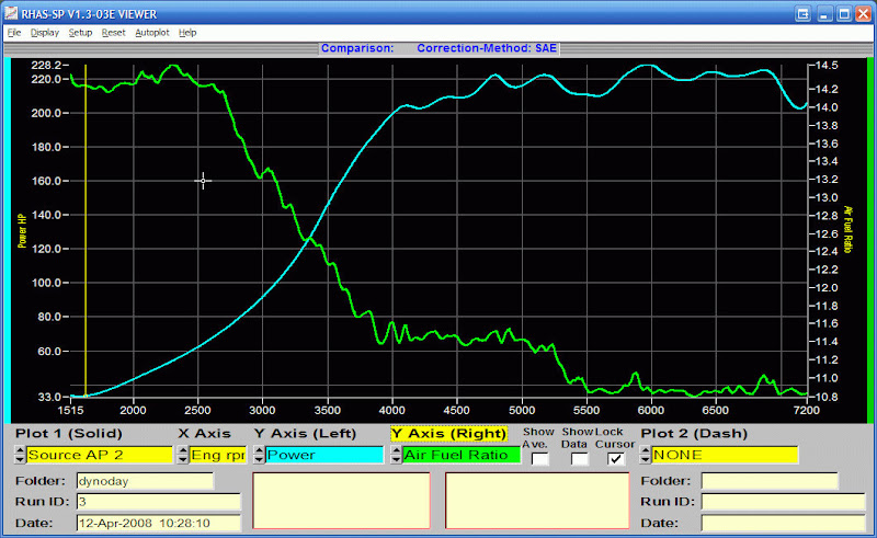

Back from page 3 with a power question!
I've been running STU locally with a pretty stock car (05 RS), but the intent is to prep it for STU. A few weeks ago I put it on the dyno, completely stock, but the results don't look normal to me. I'd like to determine if my ECU is stock, or if a previous owner had flashed it and didn't tell me.
Power vs Torque (note that the scales are different). The curve isn't very smooth up top, but that's exactly how it felt when driving it. Unfortunately I've never driven any other Evos for comparison!
Power vs Boost
Power vs air/fuel
Thoughts? Does this look like a stock Evo dyno plot?
After the dyno I put on a turbo-back with a high flow cat. Power delivery is much smoother up top, and the increase in power is significant. I've been running in BSP lately just to be on the safe side, but that's not really where I want to be right now.
Edit: The car hasn't been back on the dyno since I put on the exhaust, so I can't compare those numbers yet.

228HP sounds about right for a stock car. But you might want to ask one of the tuners (ams, buschar)

Caffeine Slug: Powerout looks similar to that of a stockish EVO8, anywhere from 215WHP to 230WHP. Ofcourse the type of Dyno (Eg: Mustang, Dynojet, Dynodynamics) and atmospheric conditions make a difference.
