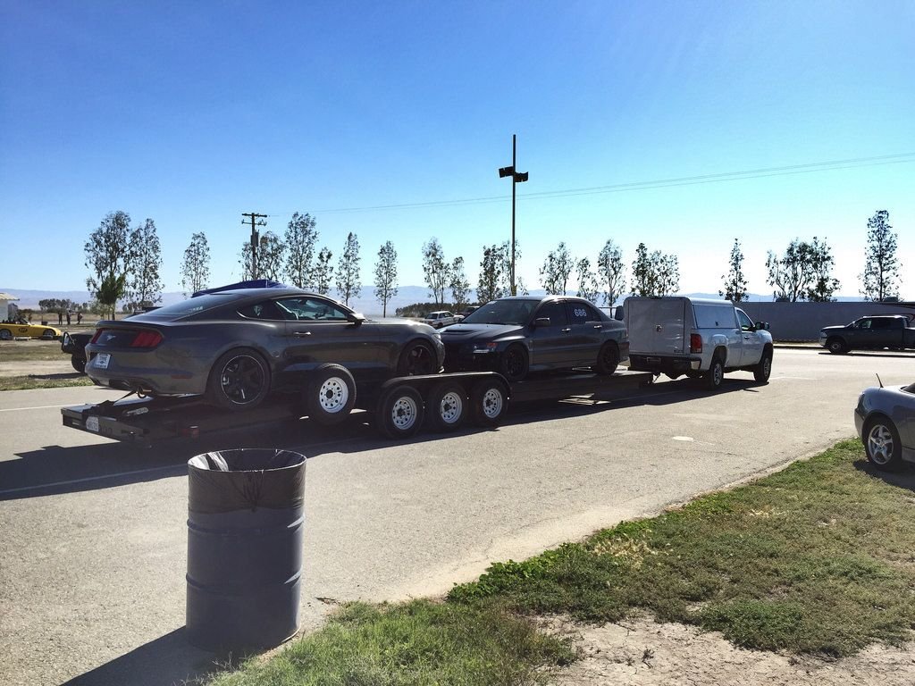

I wanted to share this picture as I am finally towing with a two car trailer to the track.
Specs on the truck
2014 2500HD 6.0 Gas With tow package.
I still find it funny how so many guys overdo it getting Cummins, Duramax and Powerstroke diesels that can tow 20k lbs just so they can tow their little 5500lb trailer to the track. However if I was towing on a weekly basis with an enclosed trailer or had a race team I would get a diesel. For my purposes I have zero regrets.
On the trailer we have a 2015 Mustang Ecoboost weighing in at 3650lbs and an Evo 9 SE weighing in at 3000lbs.
With the trailer I am just under 10000lbs.
I've towed with this setup 3 times at roughly 3-4 hour drives each way without any issues.
Averaging 11mpg+ cruising at 70mph-75mph. Plenty of passing power on tap as well.

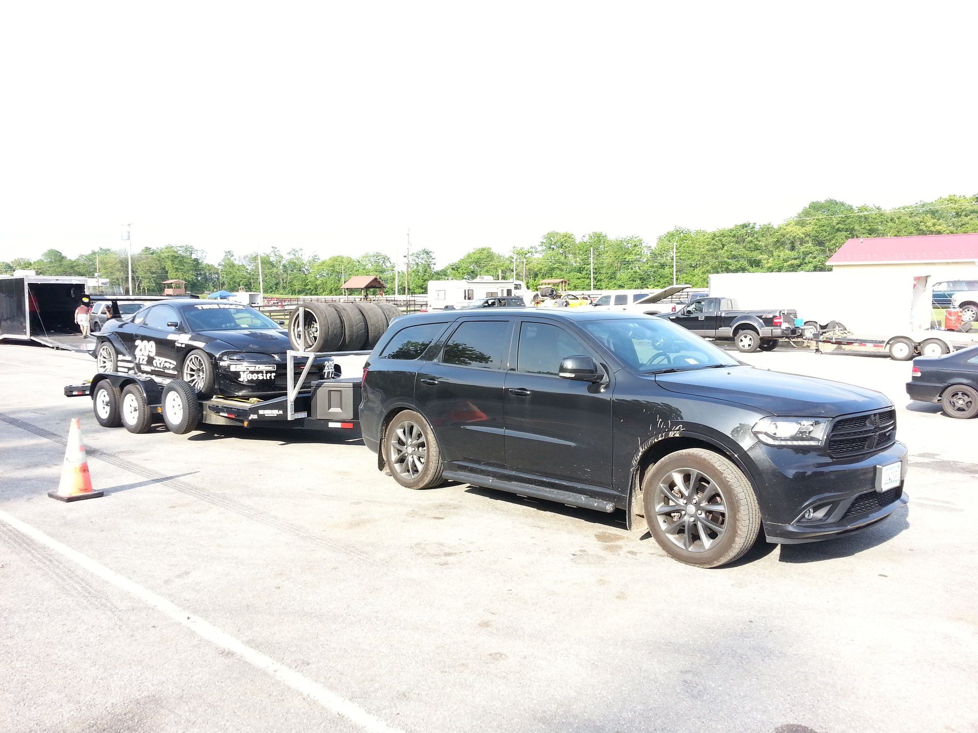

Here is my 2014 Durango RT (V8 360hp) with a steel 18' Sure Trac using e-track rails for strapping in. I use e-track because of the low clearance with the front aero.
The tire rack was added afterwards and custom built. Had this for over a year now and it's worked pretty well. Only big issue is the ramps that came with it do not go shallow enough to let me drive up without removing the front bumper cover/splitter, but that only takes me about 30 sec to get off so not a huge deal.

nice car, i've seen you at summit a few times. i usually run the white evo 9 in TT3. but i was there with the crx last week.
have you tried backing up the SUV on some wood ramp to tilt the trailer back some to give you better ramp angle so you can get the car on trailer without removing the front bumper. i like the tire rack idea. i'll probably make something similar to it. put the tires over the toll box since my trailer is only 15' and i also fit the pit bike behind the toll box.
