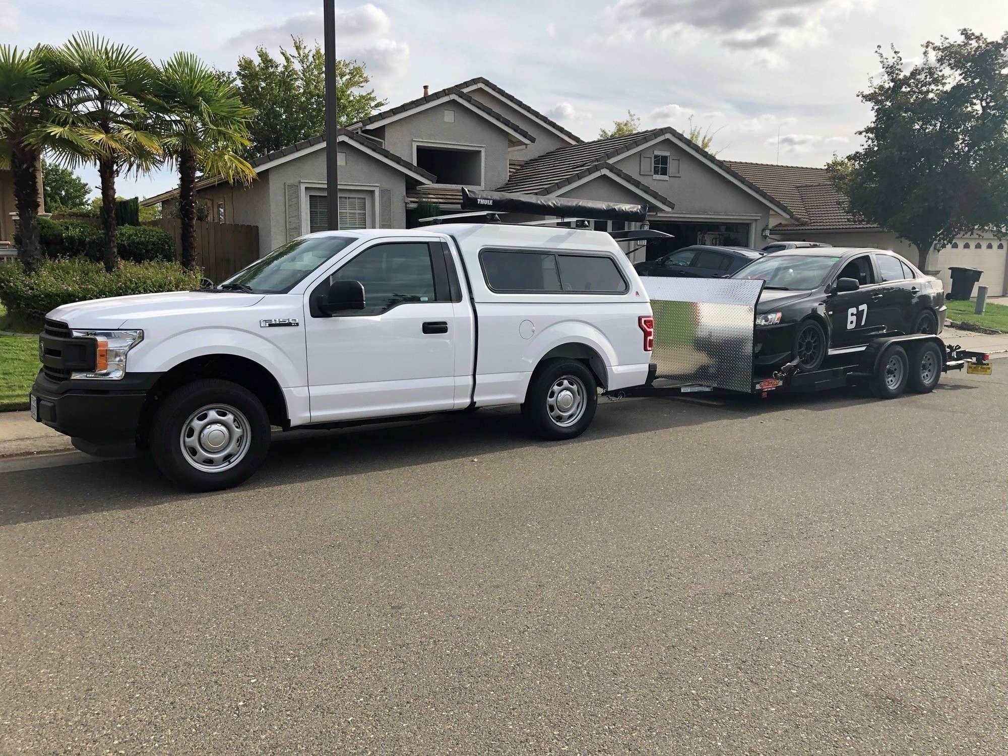

Originally Posted by GotKT?
My last track day was almost a year ago when it was cut short by catastrophic turbo failure. I limped home and decided to give the track day thing a break until I could get a proper tow rig. I also needed to let my wallet recover from a string of failures. Oh, and I also need a new tune because I don't trust my last one anymore. Well last Sunday I picked up a new F-150 XL. It's got a V8, 10 speed auto, tow package, and little else, but I got zero percent financing and the dealer agreed to add factory cruise control an no additional cost. Next steps are a camper shell and removable awning and of course a 16 foot trailer.
Took the new tow rig to Thunder Hill last Thursday. 65 MPH mostly flat drive. Trip computer says 16.5 MPG, I''s see it that's true when I fill it up next. Made the round trip on one tank with about 30 mile of range left over. I'm very satisfied with the truck so far.

You need to raise the front of your trailer based on that pic. Probably a bit less tongue weight, and then a hitch with less drop.
Old Oct 13, 2020 | 09:12 AM
  #1165
Ayoustin's Avatar
Joined: Jul 2014
Posts: 2,989
Likes: 648
From: SC
I agree. Rule of thumb is tongue weight at 10% of total trailer weight. Too much tongue weight will make life extra hard on the truck, too little will make the trailer very unstable, sometimes dangerous.
Old Oct 13, 2020 | 09:26 AM
  #1166
LetsGetThisDone's Avatar
Joined: Oct 2013
Posts: 15,973
Likes: 1,629
The trailer also should sit level. So, even if tongue weight is correct, you need to select the correct hitch. But in the pic, the truck looks excessively squatted. My raptor doesn't sit that nose high with a trailer, and it sits almost level without a trailer.
