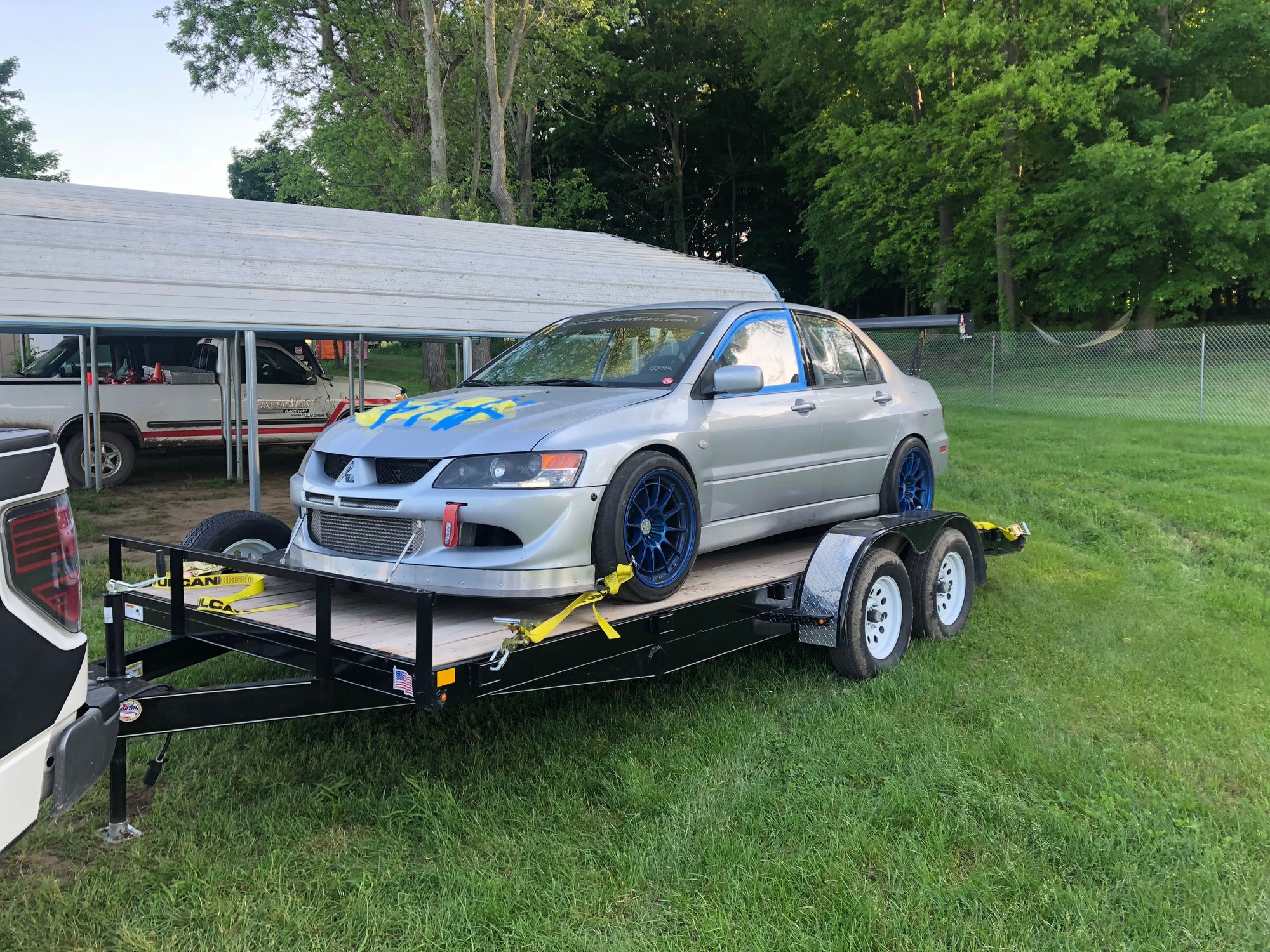

Looks like a decent unit. If you look closely you'll see that some wood deck trailers have the wood pieces sitting above the angle iron and some are below. Mine is below and that one is above. Were talking a difference in height of about an inch but I mention that as I am unable to open the doors without hitting my fender. An extra inch would have gone a long way. My fenders are removable, 2 bolts and they lift off but I ended up re engineering the driverside and made it so it hinges, no tools required. My point is take note of fender height and make sure they are removable.
Another thing I noticed is that unit only has brakes on one axle. I'd much prefer brakes on both axles. The price is low on that unit so I'd look into upgrading to brakes on both axles.

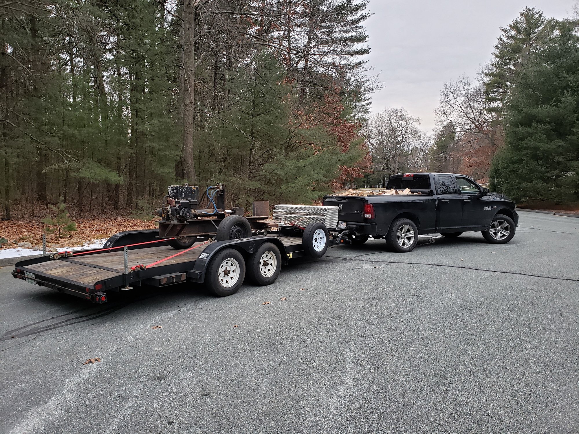

I'd go 18'. 20' could be helpful for longer vehicles but unless you go aluminum 2x3500# axles means your'e limited to around 5000# which is probably not enough for larger vehicles anyway.
I put a toolbox on the front of mine which has proved to be an awesome addition. Also doubles as a rock guard which is nice. Oh and 100% get a winch. Its amazing how useful it is to have a trailer with winch. Cut and split wood 2 weekends ago, winched splitter right onto the trailer. Picked up a big boy compressor for my buddy last weekend, winched it onto the trailer.

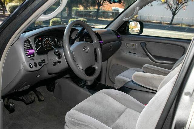

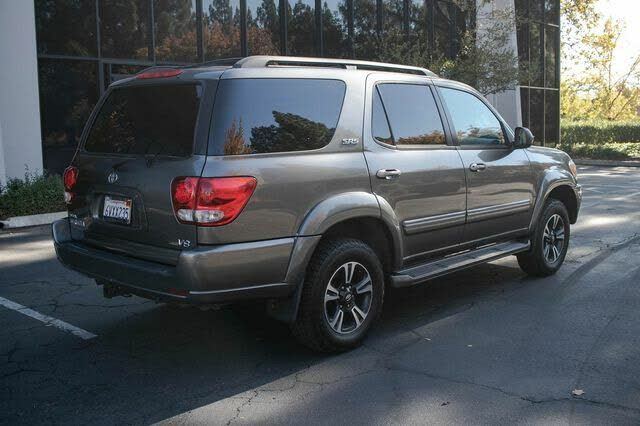

Finally decided on a truck, picking it up Sunday!
Should have a simple, open trailer, some time around June, a friend of mine is moving out of state and doesn't want to take the trailer with him. Lucky me.
