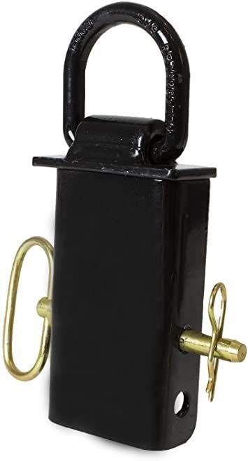

Originally Posted by kyoo
re: simple trailer - this looks about the same as what i posted, plus a small rock guard and tool box and brakes on both axles:
https://www.bigtextrailerworld.com/t...ER7KNs4xb0lveg
do you just tie it down to the hook things on the sides of the trailer? i guess i'd prefer a trailer that had those d rings..
and the lasso style is not good for suspension, correct?
https://www.amazon.com/VULCAN-Lasso-...dp/B06Y1QGHVM/
I drilled holes into the stake pockets to use those rings which allows the strap to run lower underneath the splitter without hitting anything. Plenty of companies make D ring stakes that lock into the stake pockets easily.
There's really nothing wrong with tying down a car any way. I just like going around the tires because the straps don't loosen up since the car doesn't move around as much on the trailer, same result if you go around control arms. Some people prefer to hook up to the chassis but the car will often wiggle around unless you really load up the suspension which just doesn't feel right to me.

awesome, did not know those existed - will have to check it out

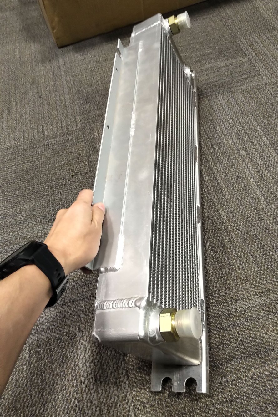

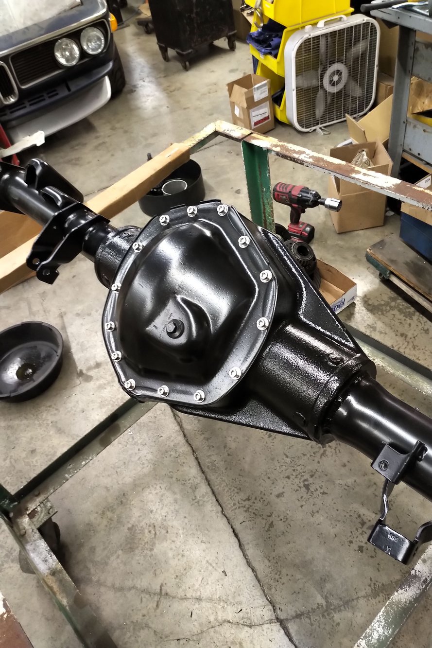

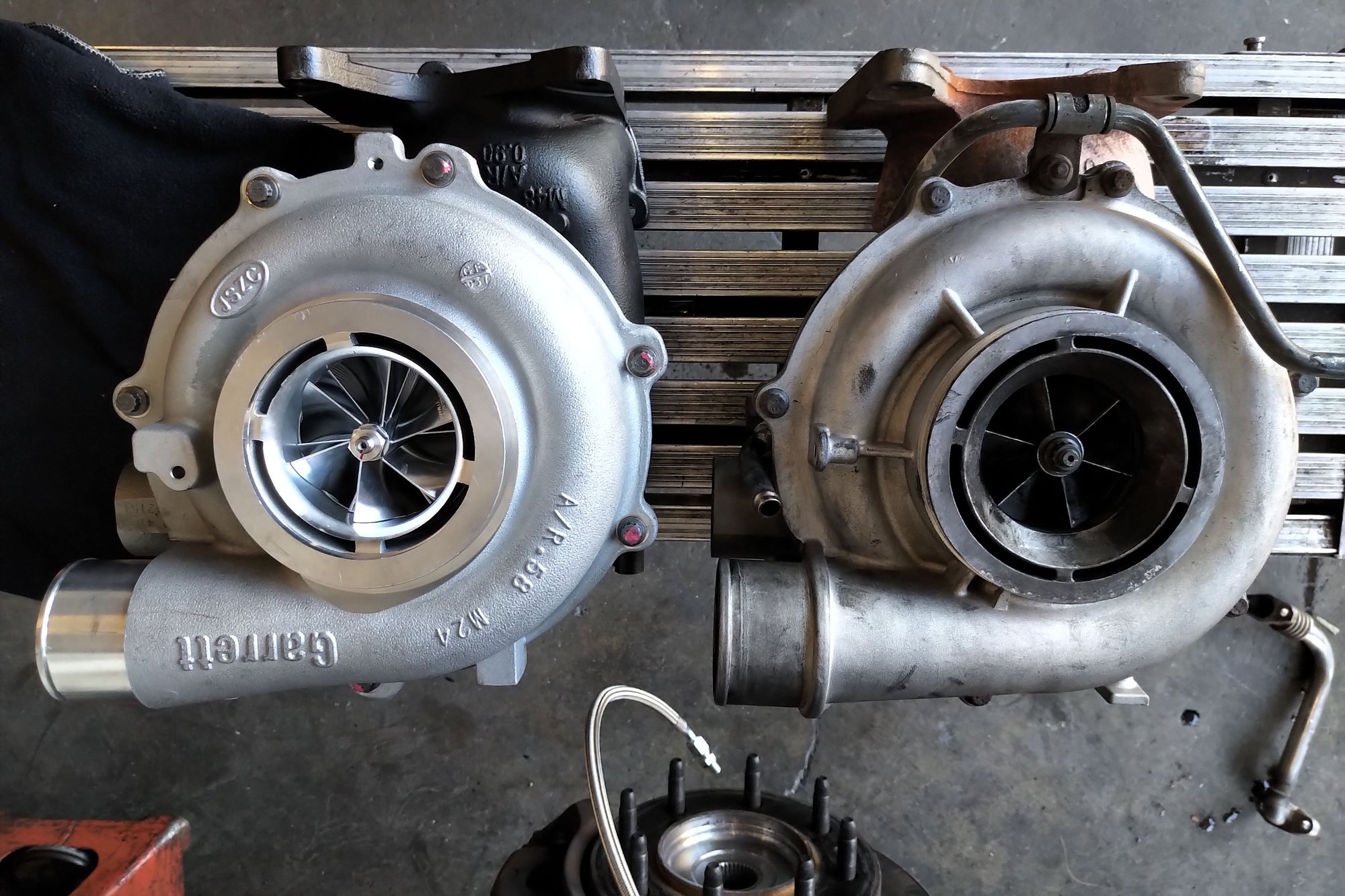

My tow rig is getting some upgrades. Looking forward to seeing how this new setup tows since I went from 3.73 to 3.42 to get cruising rpm down but I figure with well over 1,000tq to the wheels shouldn't be an issue.
