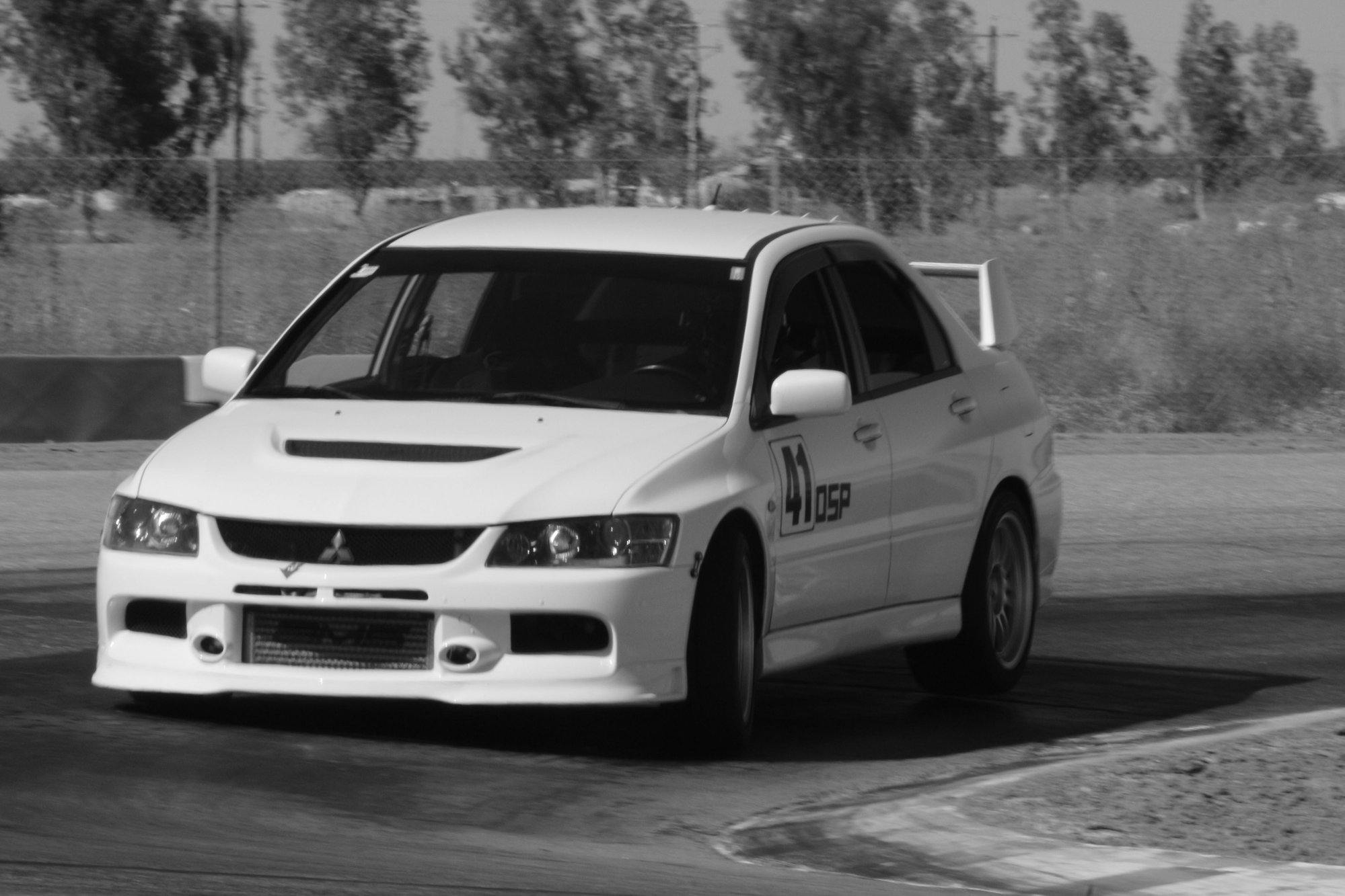

And I do pick up a tire on really tight turns. Like AutoX tight. That's how I found out my rear diff is toast LOL:

That corner is banked, hard to judge body roll...lol.
But you can still see the tire lifting . Not as bad as a guy I saw at autox, one day. R-comps on a stock setup. It must have been 6" off the ground. crazy.
