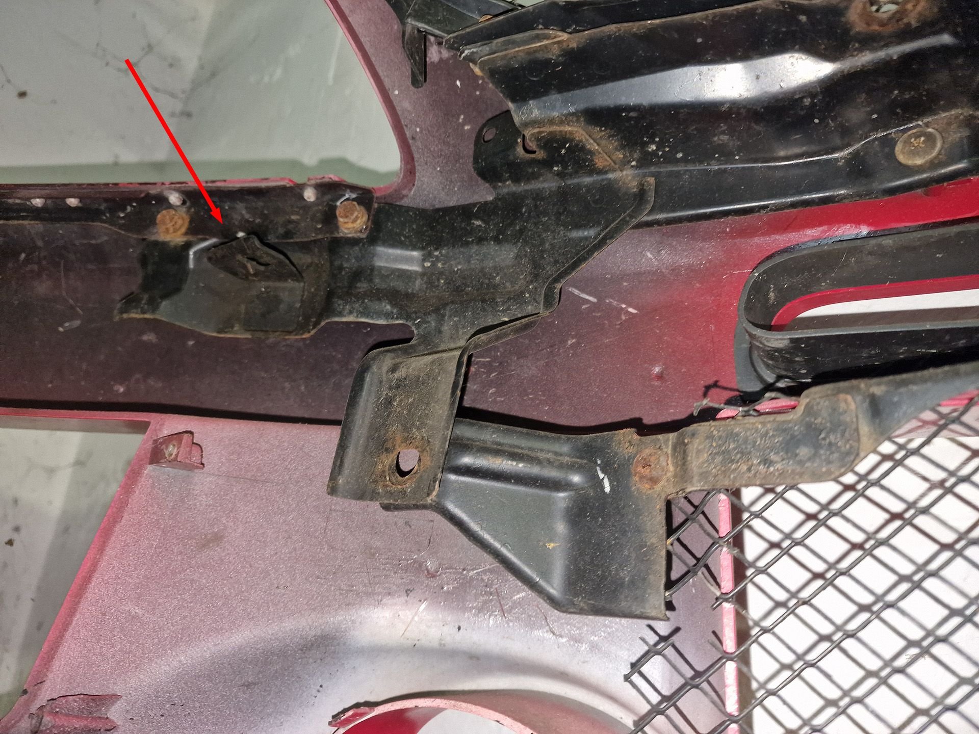

Originally Posted by kikiturbo
I am always shocked to see that crash crossmember as EU and JDM cars do not run it..
Those setrab cores are apparently very efficient.. I have been eyeing it for my car but it is $$$
if like to remove it but I’m nervous the bumper would sag without it. What do the JDM cars do without it?
my car never had it and I had no problems because of it.. EUDM/JDM bumper has a small steel edge piece inside and hooks onto two hangers that protrude each side of the IC..
mind taking a pic?

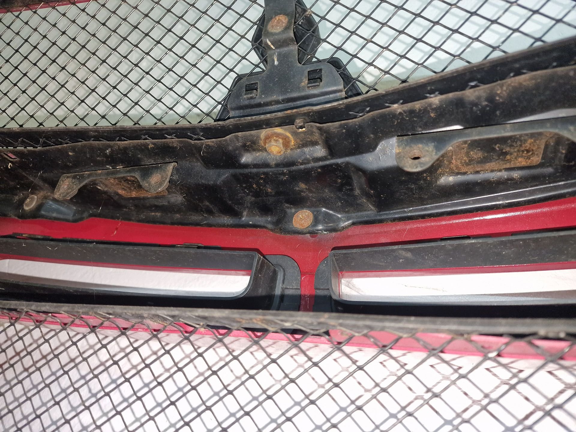

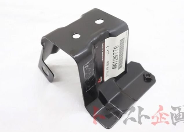

mind taking a pic?
here.. you can see the reenforcement on the bumper and where it hooks into the bumper mount that bolts to the chassis instead of the crash bar on the US cars...

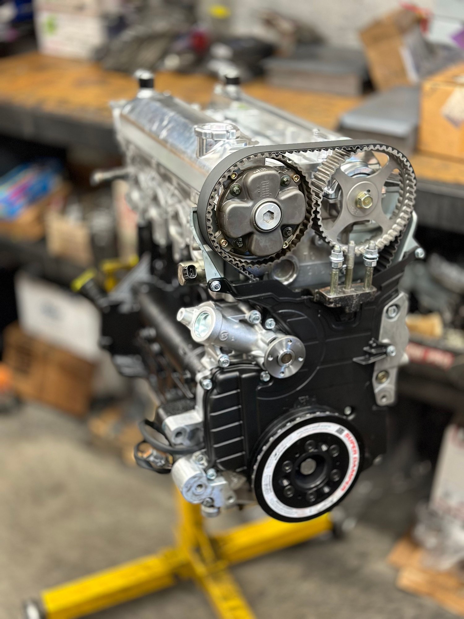

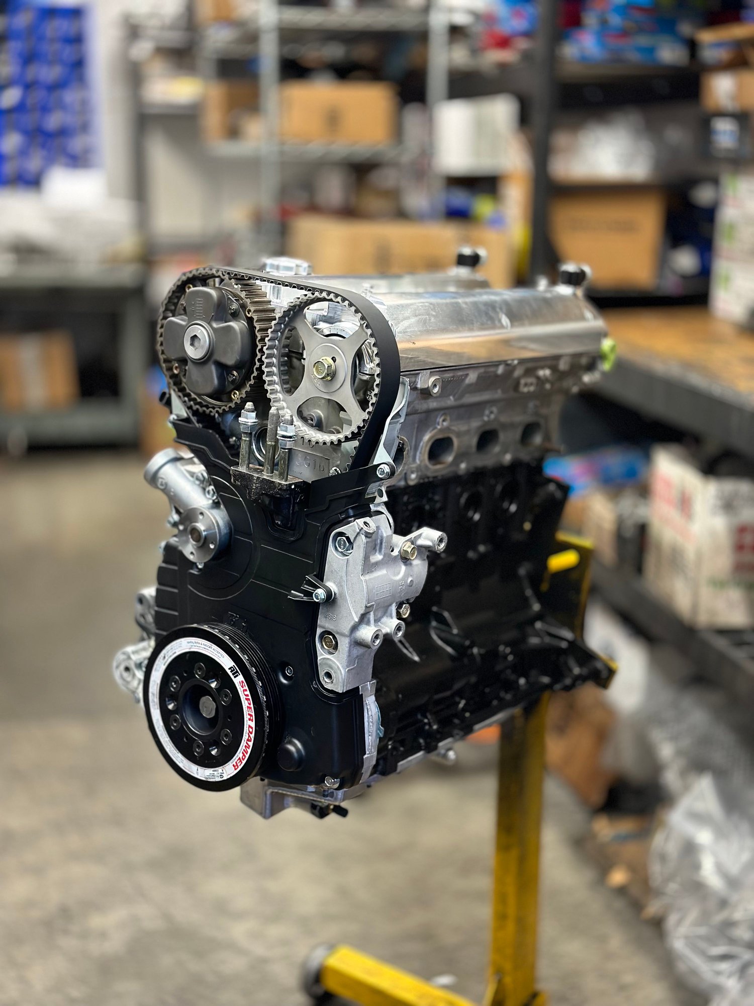

Not too many updates. Still waiting on motors from English. Really hoping to have them next week.

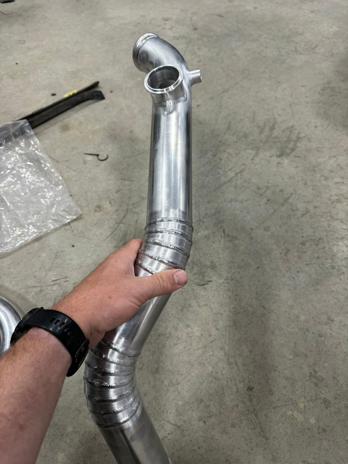

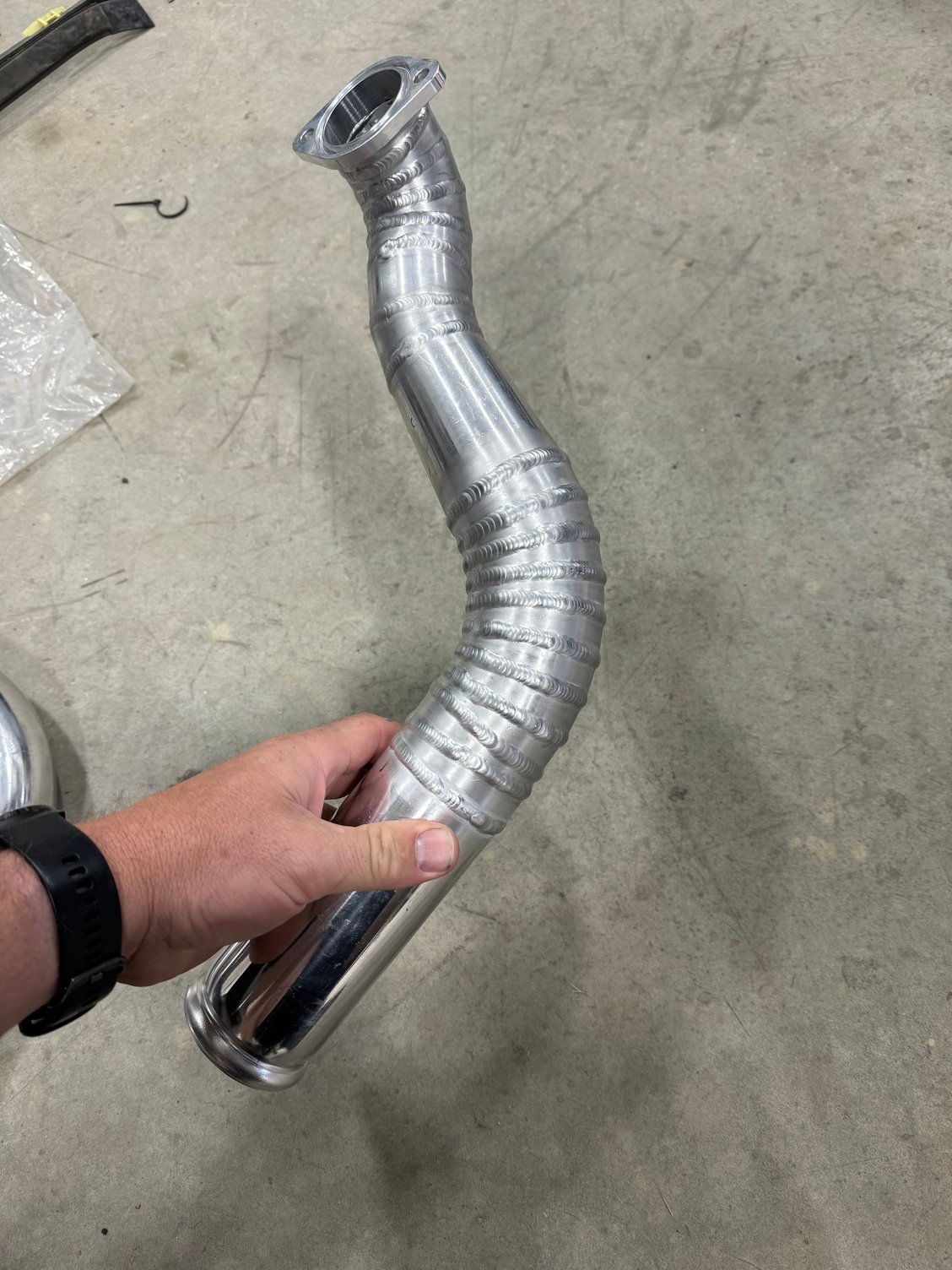

phouvanh busted out some IC piping for his car:
pics of first motor from English. This one is done we’re waiting on the second to get done so they can ship on one pallet.

Charge pipes turned out great!
