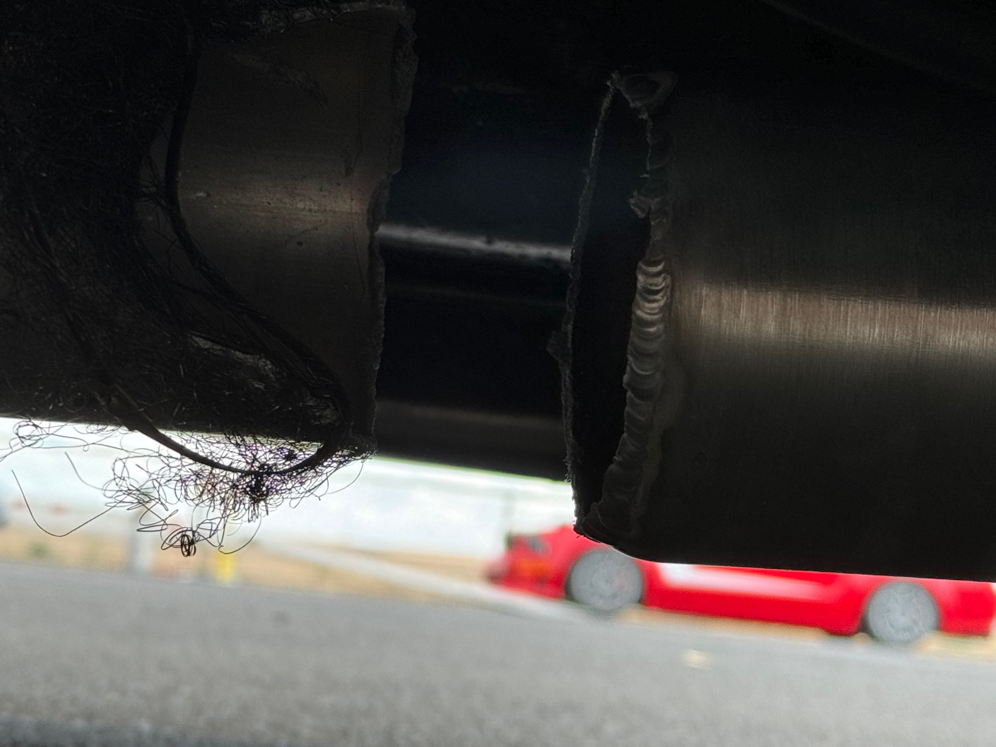

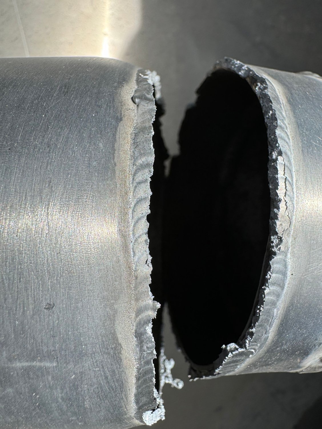

we are running an aluminum exhaust for weight reduction. They sounds pretty hollow and Tingey so we added aluminum resonators to help the tone and it was an improvement.
At the track the factory welds on the resonators broke.
we thought it was due to the heat and no lift shift of the sequential creating a loud pop when shifting.
then out to also broke in the same place on Phouvanh’s car that makes less power and doesn’t have NLS

Aluminum exhausts are tricky to get right. They tend to need bracing or you have to use pretty thick walled stuff. Sometimes titanium ends up being lighter just because you can use a much thinner wall without it cracking.
A shop I used to work at tried aluminum downpipes for Subarus once upon ago, you could watch the downpipe grow from heat expansion during a dyno pull haha.

Ti isn't the best for exhausts anyway.
Why not use thin wall Stainless instead?

aluminum is cheap and easy. But we has SSxoarts on the way to redo it

Yea i made mine out of stainless dairy tube(thin wall) and its pretty light. Probably not as light as titanium but alot cheaper.

Cheaper and breaks less
