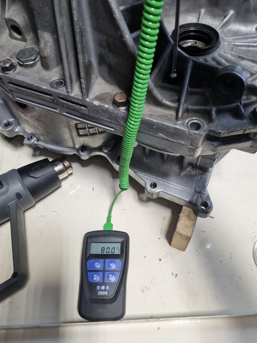

I setup a janky oven to check some gearbox preload clearances. Interestingly, the tolerances open up around 0.10mm on everything.
So the 0.13 to 0.18mm output shaft preload goes to 0.03 to 0.08mm.
Also I've installed some angular contact bearings on the input shaft, to see what it's going to run like. Jack's does a taper bearing on the input shaft, so I wanted to try angular contact. If it's no good, i'll go back to the roller ball bearing OE units.
Hot Box!
80c on the top housing, lower housing was around 90c
