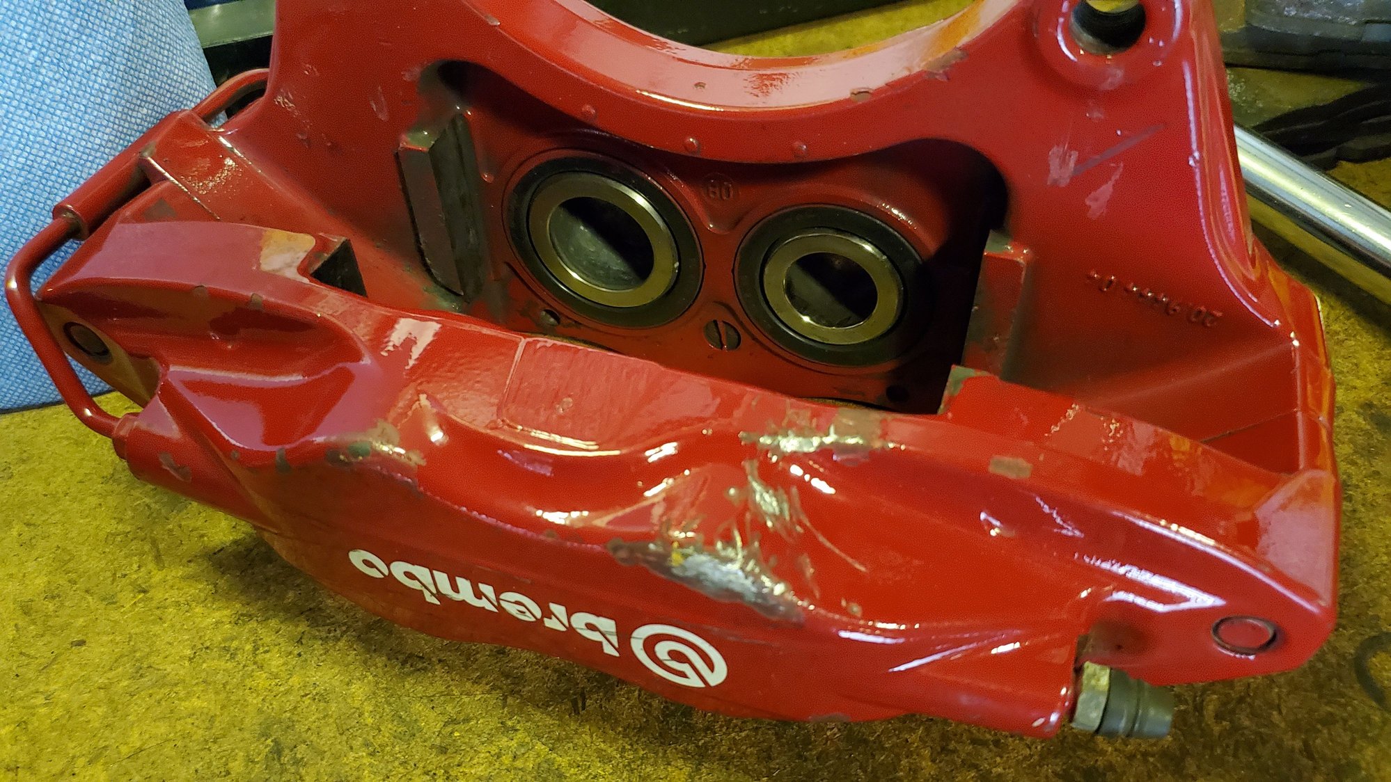

All new fluid and front calipers. I use a motive bleeder at 8psi because anything near/over 10psi starts splitting the old hoses. I had my engine bay sprayed, fixed it, then filled up my camber plate/strut tower area with about 8oz of fluid, which ran down onto the shock.....the upright....etc, when it burst again.
it was so fun.
I did notice the bleeders on the caliper sit a bit more loose than the others, while open. I'm 99% sure that was it.
I take my stuff to the track anyway, so fingers crossed!
Lastly, looks like the X calipers already have SS pistons, so no need to upgrade?

X calipers do not come with SS pistons. They're aluminum just like 8/9
​​​​​​they sure look shiny. Chrome plated?

If they're stainless, they're not factory.
They came from eBay, so no history. Weird thing is, they sent me two passenger-side calipers, so you would assume from different cars.
