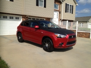

hey guys! Sorry it took so long to finally get my pictures uploaded of my OS lowered. It's hard to tell how much it lowered it but it did lower it. There is only 3 fingers gap on the back and about 3.5 or 4 fingers gap on the front. Depends on how it is setting. The ride and handling is extremely better. Again I used the eibach springs for the ASX. No problems with the install and no other problems. The pics are before and after.

Can you host the pictures on something like photobucket, Flickr, etc, instead of attachments so we can see the difference better? Also, do you have any better before and after pictures? Thanks for sharing in advance.
