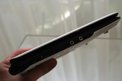

Went and bought a new computer for data logging and tuning today. I've been looking at little netbooks for about 6 months now and I'm glad I waited until now to pull the trigger. First gen netbooks had 9" screens, then they moved up to 10". Acer now makes an 11.6" with a full size keyboard - and it's $349.
This is the coolest friggin thing. It's big enough to feel like a real laptop, but it's micro sized, uber thin, and weights nothing. Not to mention it was $349. I've got all my tuning and datalogging software loaded and running perfect. That's nice because my high-power 64 bit windows xp laptop that I use to run Solidworks had issues with some programs.
Anyone looking for a new tuning computer look no further - this thing dominates.

Yea if it fits in the glove box it's a god send. Datalogging at the track ftw!

I just picked up a 10" hp about 2 months back. Sooo much easier trying to do things in the car than it is with my 17" one. And it fits in the glove with room to spare. Only thing I've yet to figure out is how to keep it datalogging when I close the screen.

I just did the glovebox test fit, and well......... it fits like a... glove? It barely fits, but it does slide right into place, with the battery up. It rubs (I made a small scratch in the glossy finish) trying it with the battery down. Problem is that it leaves NO space for the cables to exit the side of the computer. So I'll need to cut an access slot in the side of the glove box - which in no big deal to me. Bryans original review of the Asus Eeee PC planted the seed for this a while back.
