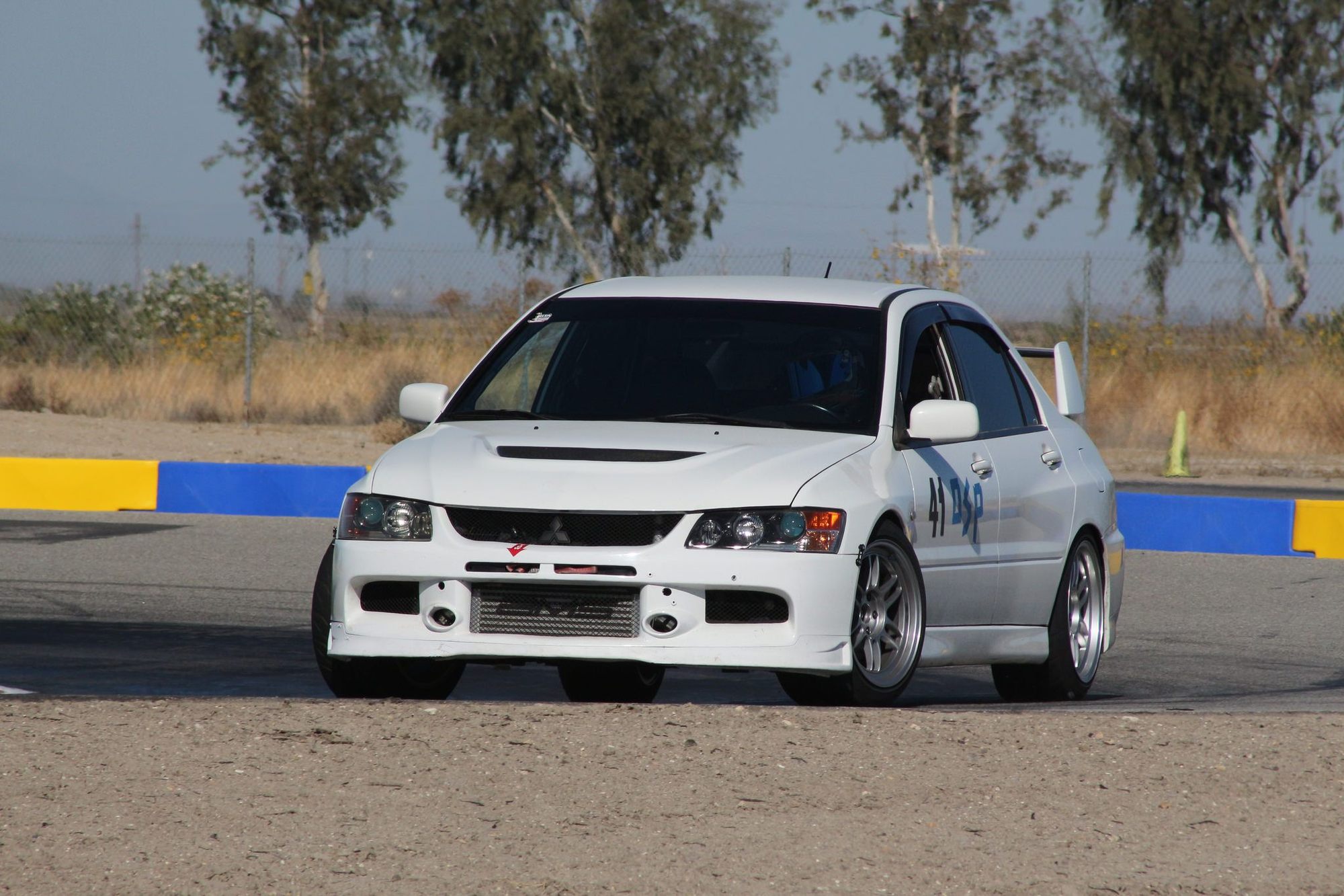

If you are running sticker tires, you get away with higher spring rates, to a point. Even Stiffer if you're not trying to be easy on tires. I'm surprised you have so much roll, to be honest.
I used to tripod on my R-S3s, too. 8k front, 9k rear springs.

Stock FSB, Whiteline RSB too. Do you have different bars? I'm surprised too.... maybe I'll "need" the springs... the Z1SS don't grip for **** anymore, I won't be surprised with picking up at least 1s from the RE71Rs.
Man your car is sexy! Autox does tend to generate more roll than road racing, I'm actually surprised/impressed you got on 3 wheels there! Not sure what you're running now, but that does tell me you would want more spring, no?

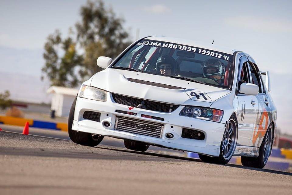

At that time I was on stock sway bars. I couldn't go with heavier springs without losing grip from the tires. I would have ended up killing them and sliding all over. I had enough roll to keep everything grippy.
I'm now on one of Robi's RSBs, adjustable endlinks f/r, 9k/11k springs, and Bridgestones. I need to drop to 10k in the rear per Rob (and I agree). I may have a pic of how the car turns now. I'll look.
Last event, on current setup:
