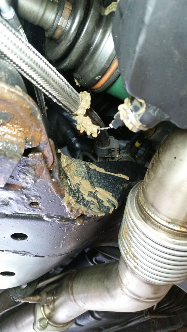

Not much excitement here to report. Threw the car up in the air on Sunday to check for leaks and get her ready for a sticker and found this mess:
Spend a few hours cleaning that up bc grease got flung everywhere. Good thing I cleaned my engine bay prior bc she already looks gross again. Picked up a new boot on Monday, had the day off and installed the new boot and put her back in. Having never pulled apart an axle prior it was very easy.
Now, Im back to playing my favorite game Eric vs State of MA. Will I get a sticker? Nobody knows...
