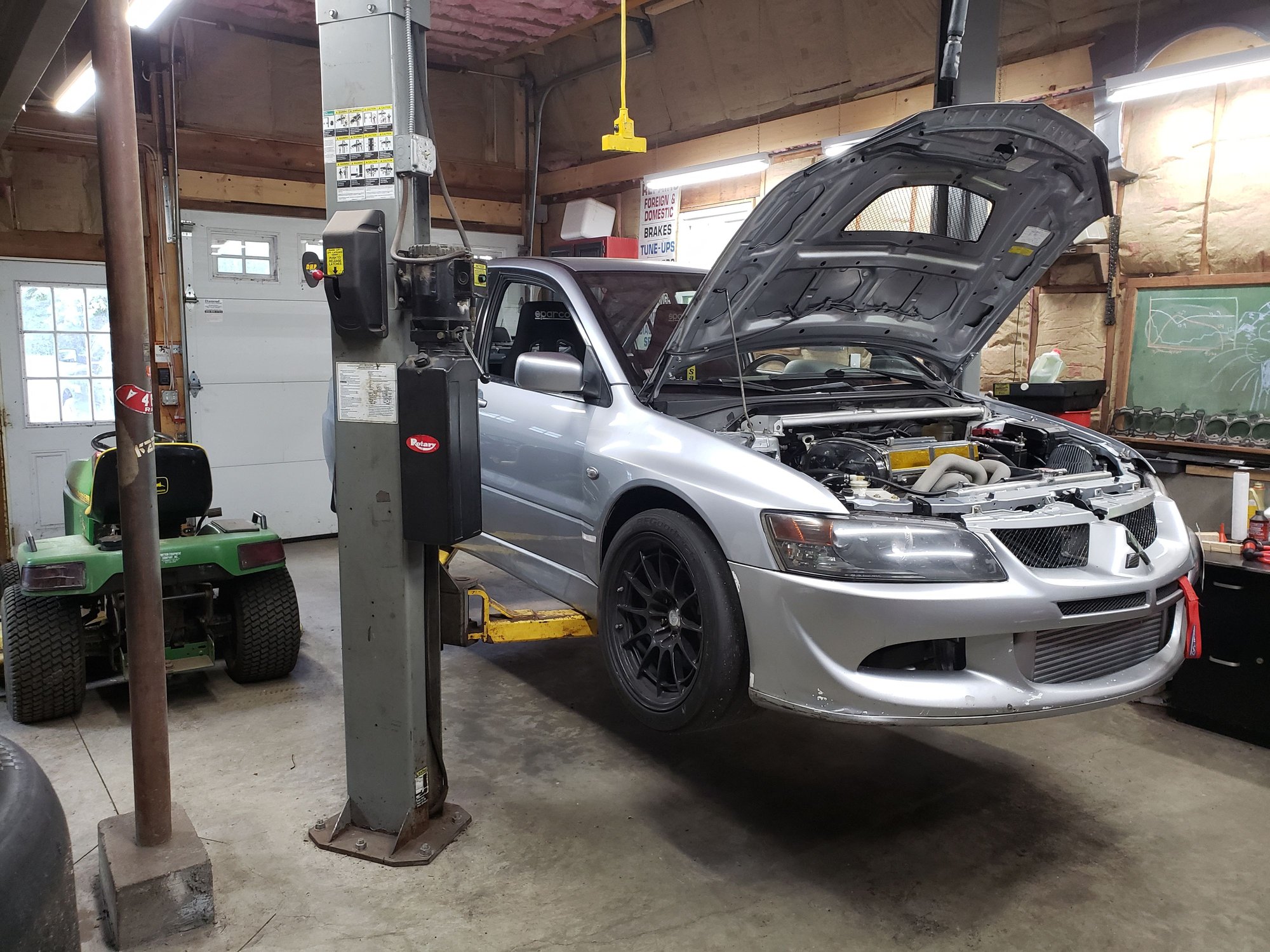

Im sure im missing a lot of stuff and essentially just typed an essay and all people want to see is pictures. So here are a couple pics and a video. Ive done 6 events in the car and had a failure 5 out of 6! I will say when the car is running the setup is amazing. 2.2 +EFR7670 is kicking ***. If I can get it to stay together I'll be a happy man. But until then I continue to chase my tail. I have an event this Saturday and in typical fashion car is nowhere close to being ready. Hopefully I'll get tracking on my head tomorrow and can throw it back together Thurs/Fri and load up on the trailer and maybe just maybe she'll hold together on Saturday
Video from a few months back as Im paranoid of coolant temps
Natural resting place
Current status

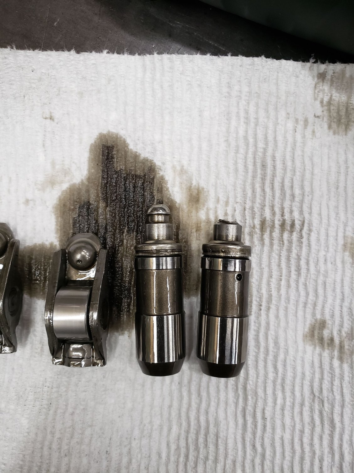

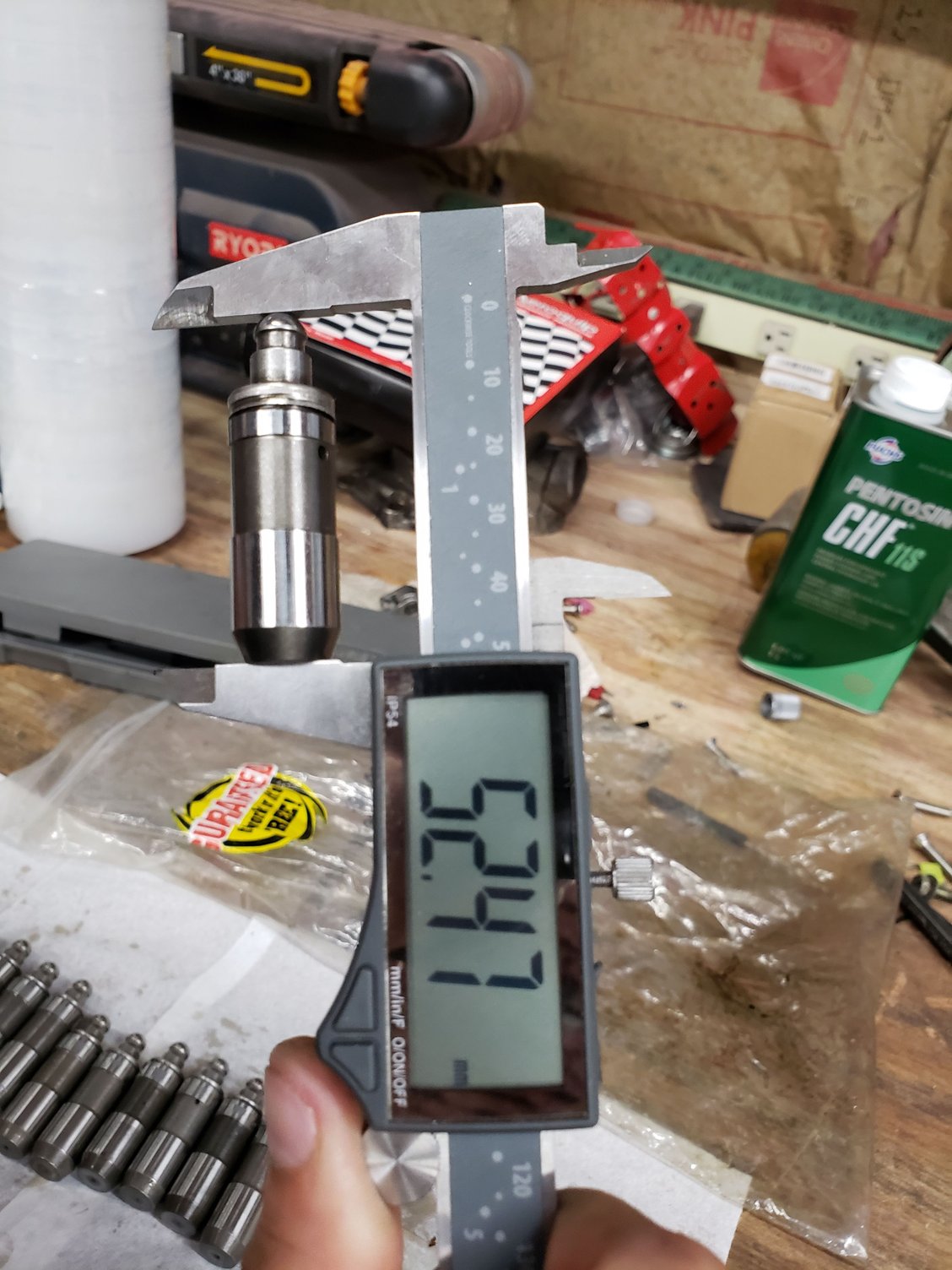

One change I'm making this time is going back to OEM lifters. I had GSC lifters in there but supposedly their failure rate is higher than OEM. I did some testing last week and found something interesting. I pumped up two lifters an OEM and a GSC and noticed that the GSC unit is slightly shorter. I'm not sure if this even matters but found it interesting.
OEM Lifter
GSC Lifter
