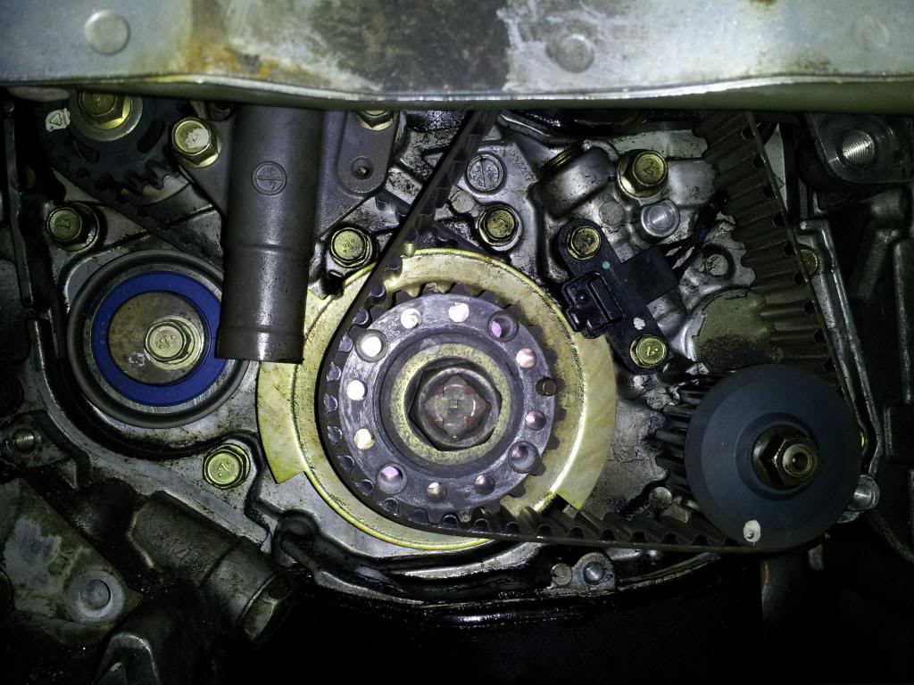

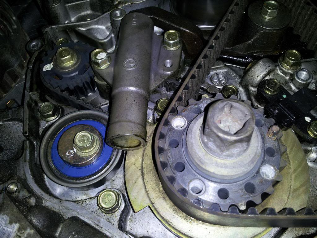

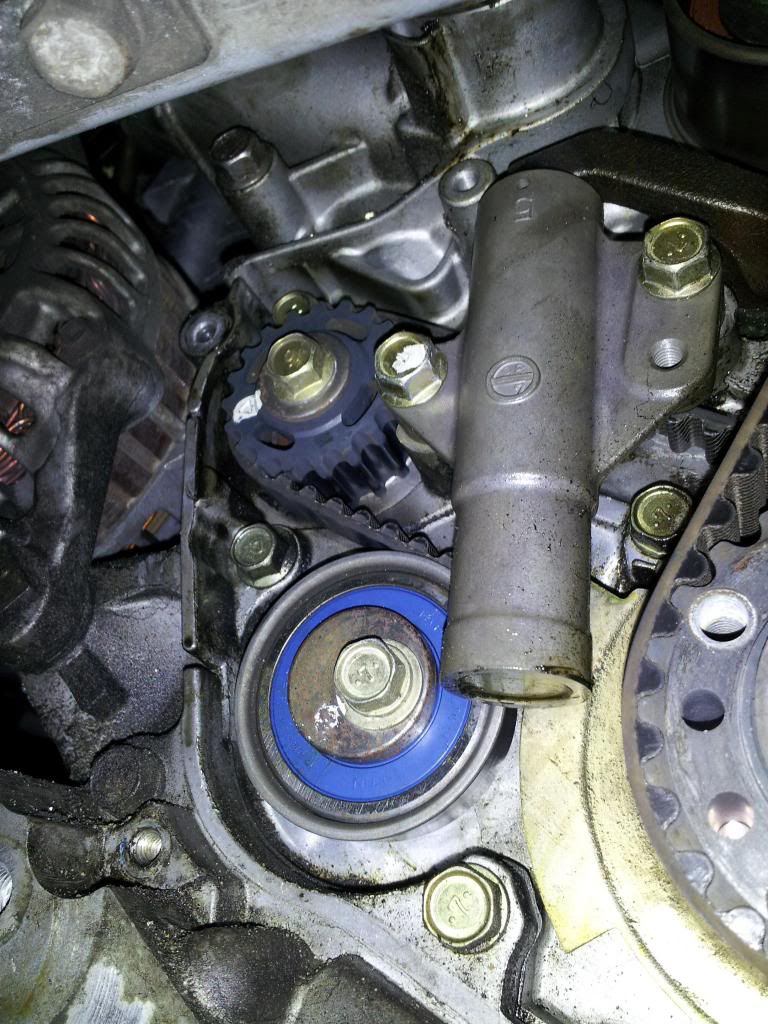

Oh god that reminds me of what I went through for literally years on my original engine. I couldn't for the life of me figure out where the oil was coming from. I found some of these pictures that show some of the mess that was made in that same area as you are describing. There are a few bolts that go into oil galleys but I'm told that is only the case with certain blocks. For example bolts for the tensioner supposedly do but when I looked at mine with a flashlight they didnt appear to cut into anything. There is I wanna say either one or two of the bolts that mount the side engine mount that require sealant
The only thing that I never pulled and replaced/ resealed was my oil pan actually for the exact reason you mentioned above bc, well it probably sucks doing on the car, lol. At one point I thought perhaps it was my HG after all these years but that didnt fix it either. I wish you luck but I also feel your pain. If my new motor leaks Ima be pissed, lol!
EDIT: IDK why it linked the pictures like that but take a look at this thread I created here to show my struggle. There is actually some decent info in there on oil leaks as you're not alone; many of us seem to struggle pinpointing exactly where it was coming from. Disregard the title as I attributed that to my valve stem seals which clearly had seen better days. Hopefully my new 9400RPM limiter will save those moving forward!
