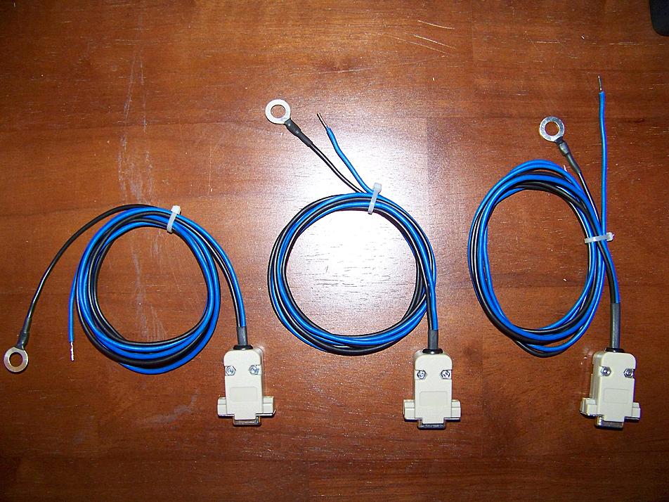

How much interest would there be if I prefabbed some of the serial connectors with blue wire(3 ft) and black wire (3 ft + t-lug for ground) with instructions for the AEM wideband? PM me if you are interested

Made 3 today here is a pic of the finished product. All you have to do is connect the blue wire to the blue wire coming off the AEM UEGO and ground the black wire... PM me up if you guys need one...

One has a home... I still have 2 left!
