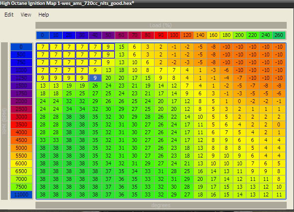

1000 should be good for 272's.... so what is your timing in your idle cells now ?
you just have to be careful because too much timing brings on the P0300

I that code...that little bugger comes on once in awhile, sometimes could be months in between each time I think its from the clutch. After that is when it happend
Here is where I'm at
change your 5's to 7's... then your cell where it is at 1000 rpm and 40 load, change that to 7 as well.... the cells surrounding the 7's change to 9
Like so correct?
Like so correct?
nay... 1000 rpm 40 load change 9 to 7 ...
change the 13 to 7
change the 2 20's to 15 id think... just more or less smooth the transition
change the 13 to 7
k done and changed the 1000rpm 9 to 7 and the 1000rpm 50 load from 13 to 7, and the 20's to 15

Originally Posted by Inprogress
Bigric09,
Does this help with idling? My car sure is struggling, its at 6* in the cells where your saying to do 7*, so I may try adding 1* to make it 7. Should help shouldn't it?
it can... depends on other factors though... idle rpm, vacuum leaks, maf scaling, dirty filters, exhaust leaks around the front O2, injector scaling and latencies... and im sure more im forgetting
Right arm I'm going to go test this out I'll post back within the hour
and so... ?
and so... ?
O man sorry I was out driving forever and then made a couple hot toddy's cuz I've been sick for a few days and I kinda got buzzed. I need to clean my air filter too but back to subject, over all the car feels really good and have only got a 1 knock count randomly. The idle stays just around 800 which is good right? I don't think I've ever seen my car idle at 1000 unless its cold outside.
