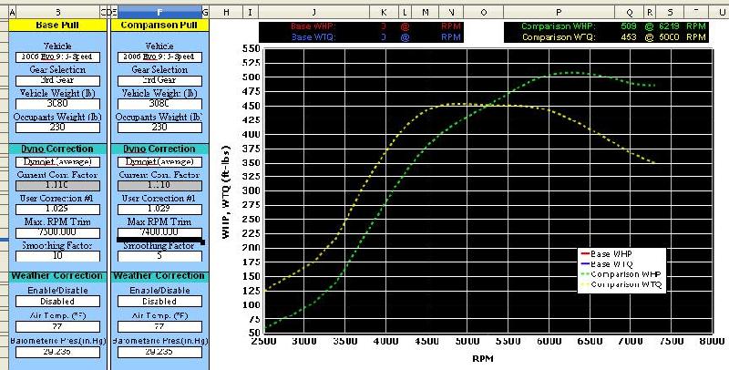

Ok, I went out did a little more tuning this weekend with the addition of a Prodrive bcs. I've never been on the dyno and these numbers seem a little high to me. I have even lowered the weight of the car to 3080 on the dyno sheet to get the numbers down. Using the default 3280 gives about 35 more hp.
I see a max load of 428 mid range 330 up top. Maf hz tops out at 2800.
Relevant power mods:
Evo 9 se
80mm Red
FP-4r cams
Nisei 3.7 comp intercooler & licp
RC 1200cc
E85
Single modified Walbro + Aquamist 100% meth injection (need a double pumper)
Tanabe catless tbe w/stock o2 housing
modified stock airbox

Nice work as always JOT, I noticed using open office so far everything looks good but 2 things: Neither the base pull or comparison show any other dyno correction options when you hit the dropdown menu. and also on the actual graph wherever your max power is the rest of the curve is cut off but not sure if this is supposed to be like that?
Evo 9 se
80mm Red
FP-4r cams
RC 1200cc
E85
It is VERY possible that you are fairly close to those HP levels with your mods. The Dynojet data isn't as 'confirmed' as the mustang dyno #'s are at this point, just need more datalog files from people that got logged just after their dyno pulls on a DJ. Get your car weighed and then use the Mustang Dyno choices and you should have some pretty accurate dyno simulation numbers!
I will look into the Dyno Correction Options not working in OpenOffice, you are running VDR version 5.71 correct? Also, make sure you increase your 'MAX RPM TRIM' if it seems like its not diplaying your entire RPM range of your pull. Its not supposed to stop at your peak power, it should display the entire pull.
