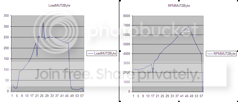

Ok ive been working on my tune for a bit today and have some questions about maptracer and the 2byte load and rpm values.
How does the maptracer deal with the load spikes? this is what my load looks like on a recent pull. Sometimes I get spikes sometimes and other times I dont. See below
So when map tracer is looking at the log file how does it deal with these spikes to properly plot on the timing and fuel maps?
Also what are you guys using for "data values" Its set on average as default it seems. Is it averaging all of the values and plotting ceratin areas? That doesnt seem to be an accurate way to tune...? Especially when plotting knock sum counts. Take a look at the screen shot below. You can see where the tracer has plotted knock counts on 4 different cells. I have 4 different lines in my log that have knock They are all plotted correctly but where did this 0.5 count come from? Ive highlighted the cell in question and its corresponding line in the excel sheet.
Once in a while when i stop the logger it puts some rabdom number for all the values on the last line. Something like 13.23564. If the tracer really averges values then this will greatly effect a small value like 1 count of knock. Is this a glitch in EvoScan? See Below
Old Mar 7, 2010 | 01:30 PM
  #255
hediki12's Avatar
Joined: May 2009
Posts: 522
From: mnt vernon ny
ur load spike is 320 ish... your maptracer wont show it untill you rescale... for 320 load.. but i cant see it on you log... weird.. is that the same log as displayed on maptracer and the exel chart?
