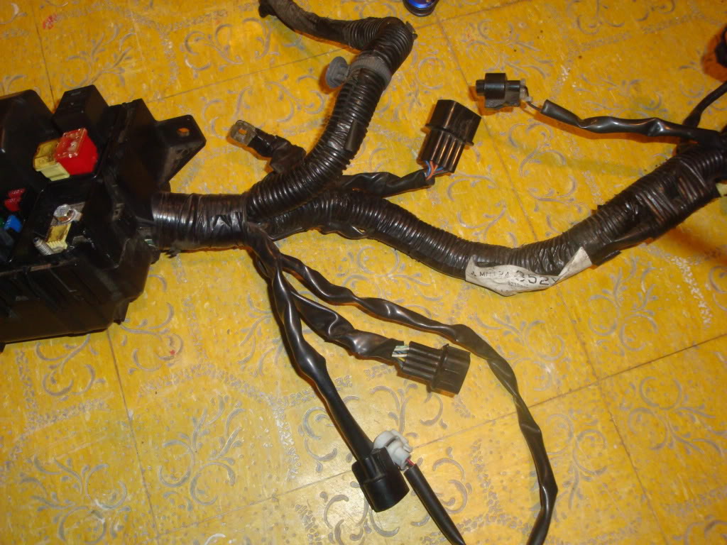

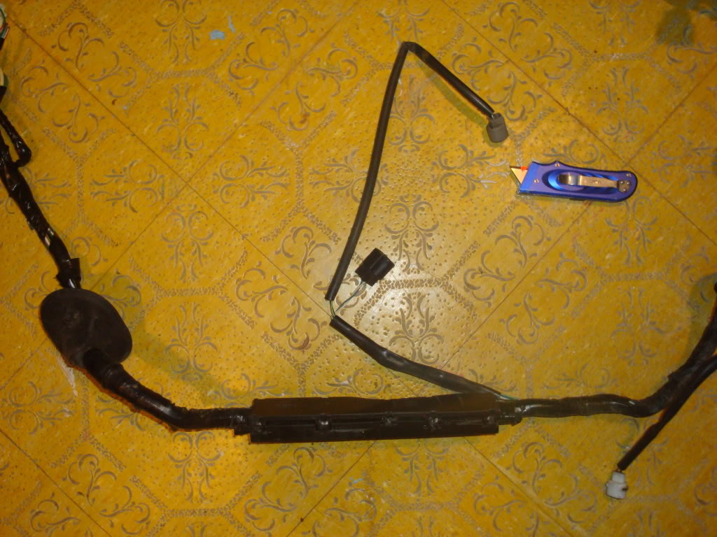

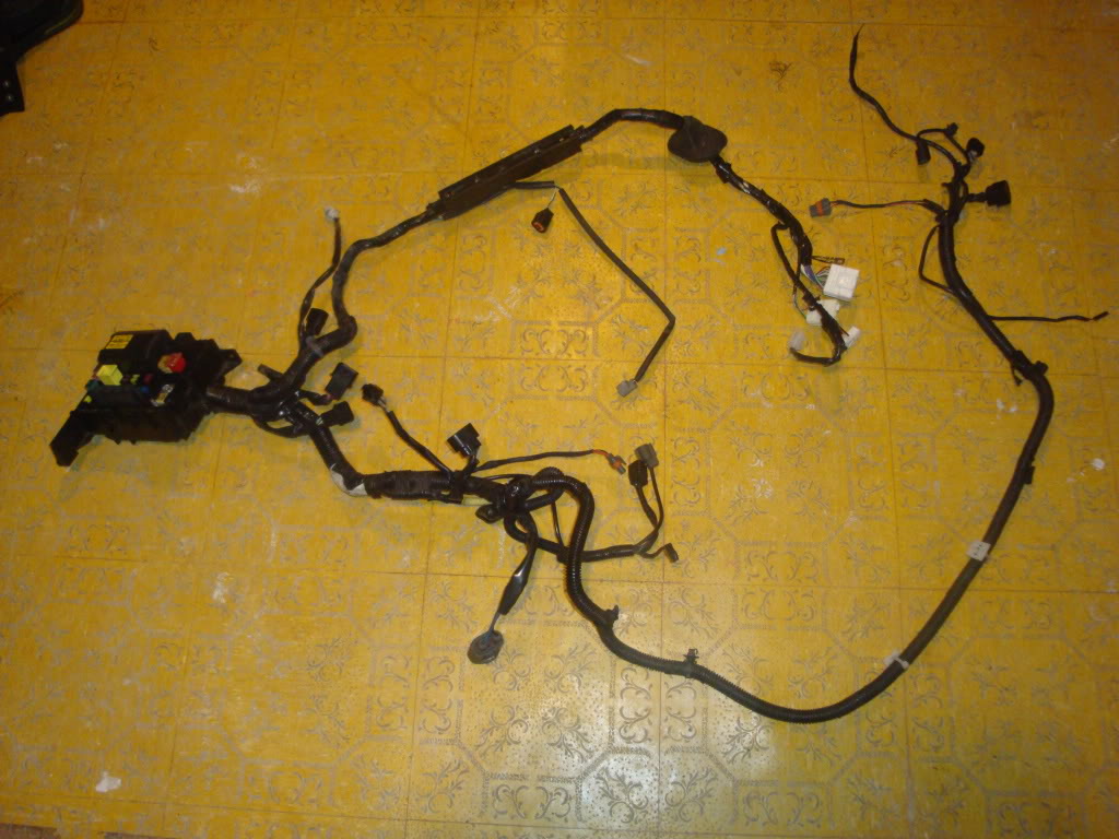

StreetThisEvo
what the hell have you got me into. holy crap. i could not sleep knowing i had extra un needed crap in the fuse box/ driver fender harness so i pulled it out.
i have been working on it for a good 2.5 hours. but i feel like i am either removing things i should not be or im not removing what i could.
i am not sure what your fuse box looked like. but i have a few questions if you do not mind helping me out with this.
the 2 relays that have the * ''snow flake like pic'' on them. are they strictly A/C related? i removed both of those relays and also both of the * 30A green fuses. im guessing that's all A/C crap. also i removed the wires that where ABS related.
also that 1 wire that go's to the power steering bump. what is that wire for and do we need it?
i have a few more questions but let me get some pics up.
Old Jan 23, 2012 | 10:31 PM
  #774
EvoDan2004's Avatar
iTrader: (94)
Joined: Feb 2005
Posts: 8,984
Likes: 8
From: New Jersey

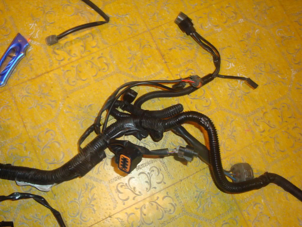

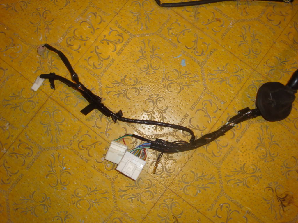

ok here is my harness before i murdered it.
Size:  135.9 KBName:  DSC02648.jpg

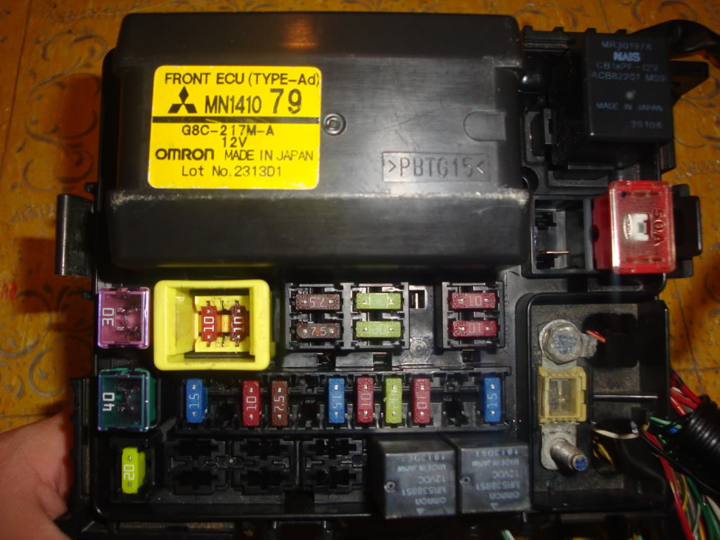

ok and here is my fuse box after i removed what i did so far.

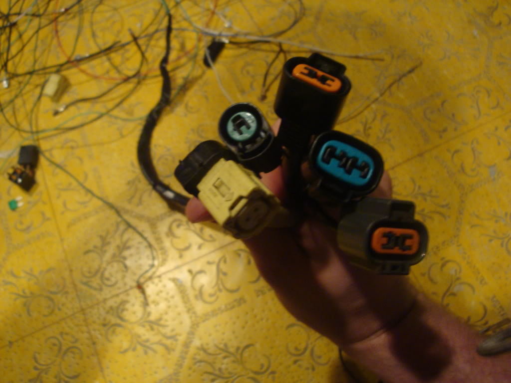

and here is the connectors i have removed so far

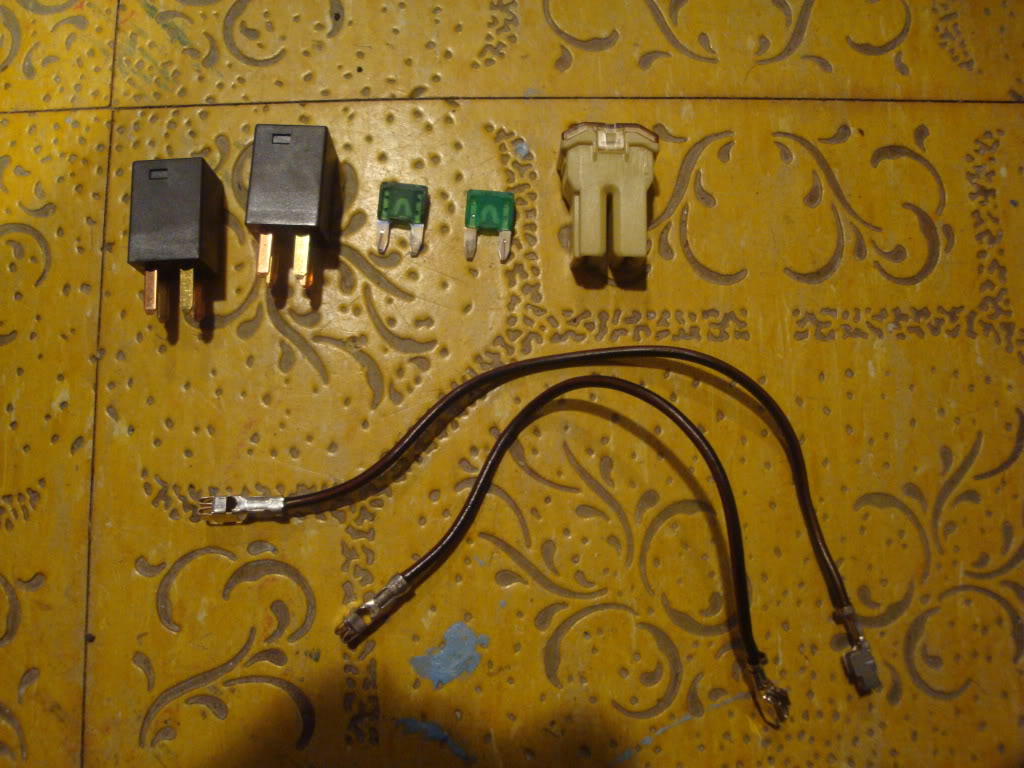

and here is the fuses and relays and some jumper wires i have removed so far

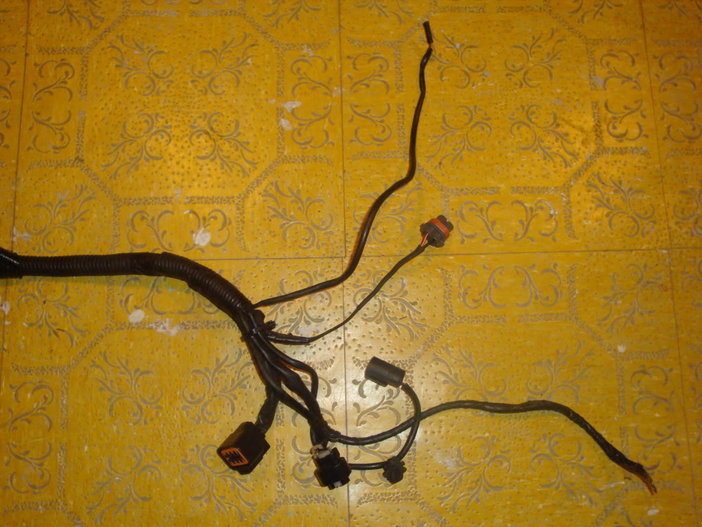

and here is the wires i got out so far. i kinda expected more then this

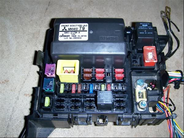

im doing this so i do not have to keep going back and forth. SterrThisEvo i hope you do not mind. if so i have no problem removing it.
here is my box ''after'' VS his box ''befre and after''
mine after
his before
his after
ok now looking at his box and my box here is what i notice is different.
he has 1 relay left. its the 3rd one in. i have 2. one is the horn ''C'' and the other is ''B'' which looks like a low beam icon. i dont know why he does not have that.
also he does not have the ''6'' 15A blue fuse like i do. it is the same low beam type icon
also he does not have ''9'' 10A red fuse. that icon is what? A/C? im not sure.
