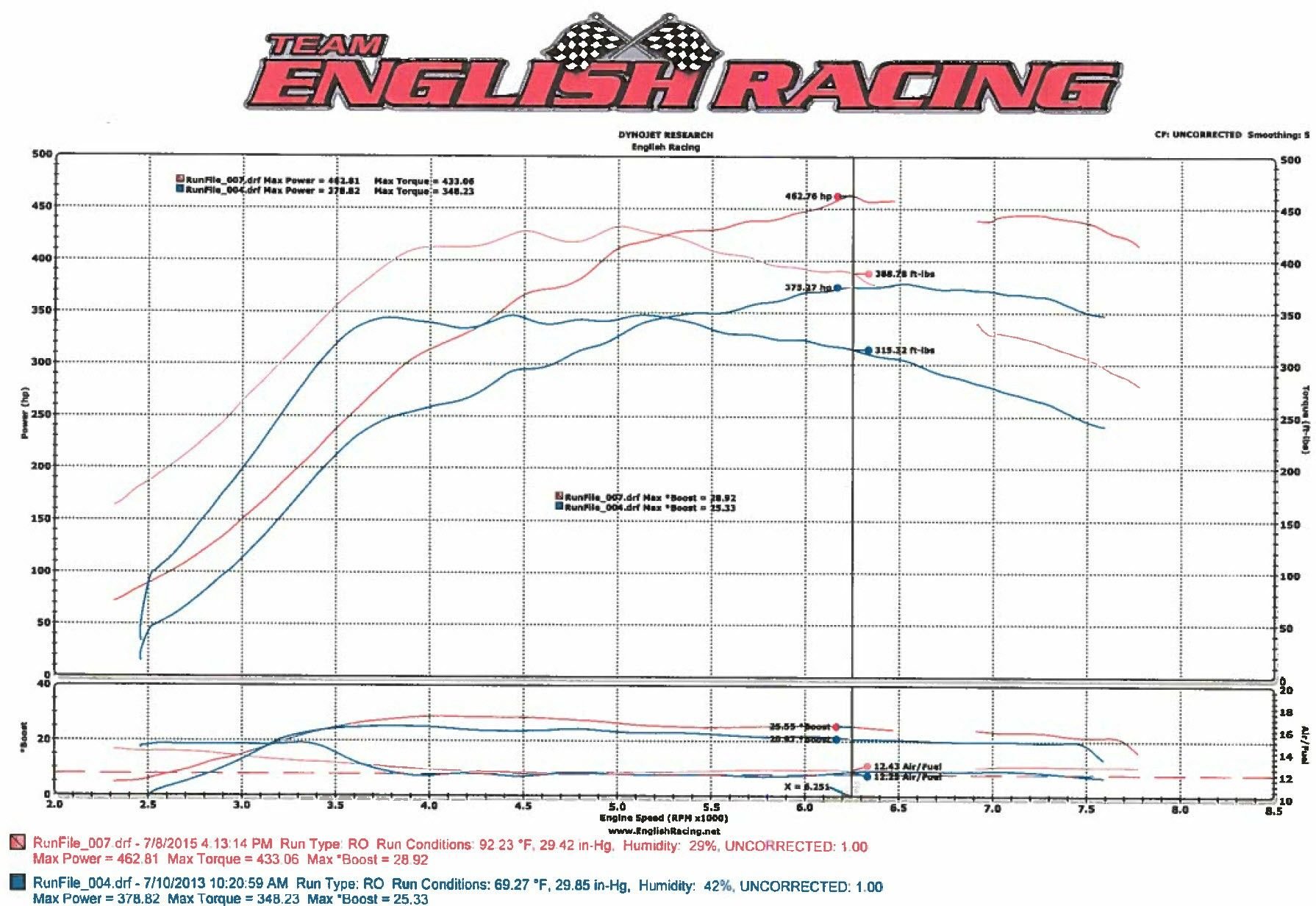

Here's my conservative tune numbers. Boost peaked 28psi and tapered to about 23psi and it was over 90 with 30% humidity. I'm sure I can work on duty cycles to get the top end to hold boost but for now its safe enough for the tour/pro the next two weekends.
The second plot is from stock motor/turbo/cams/fmic. I like that with the 2.3 and bigger turbo, the plot just moves up. No loss in spool or top end. Just more everywhere.

LetsGetThisDone's Avatar
Joined: Oct 2013
Posts: 15,973
Likes: 1,629
Do you plan on turning it up more in the future?

Probably not, I don't drag race or anything and care more about a big flat torque curve and not boost spikes. So if redline wont hold 30psi then I wont spike over that.
In autox, torque spikes just break parts and is harder to drive. Big, flat, seamless delivery is the goal.
