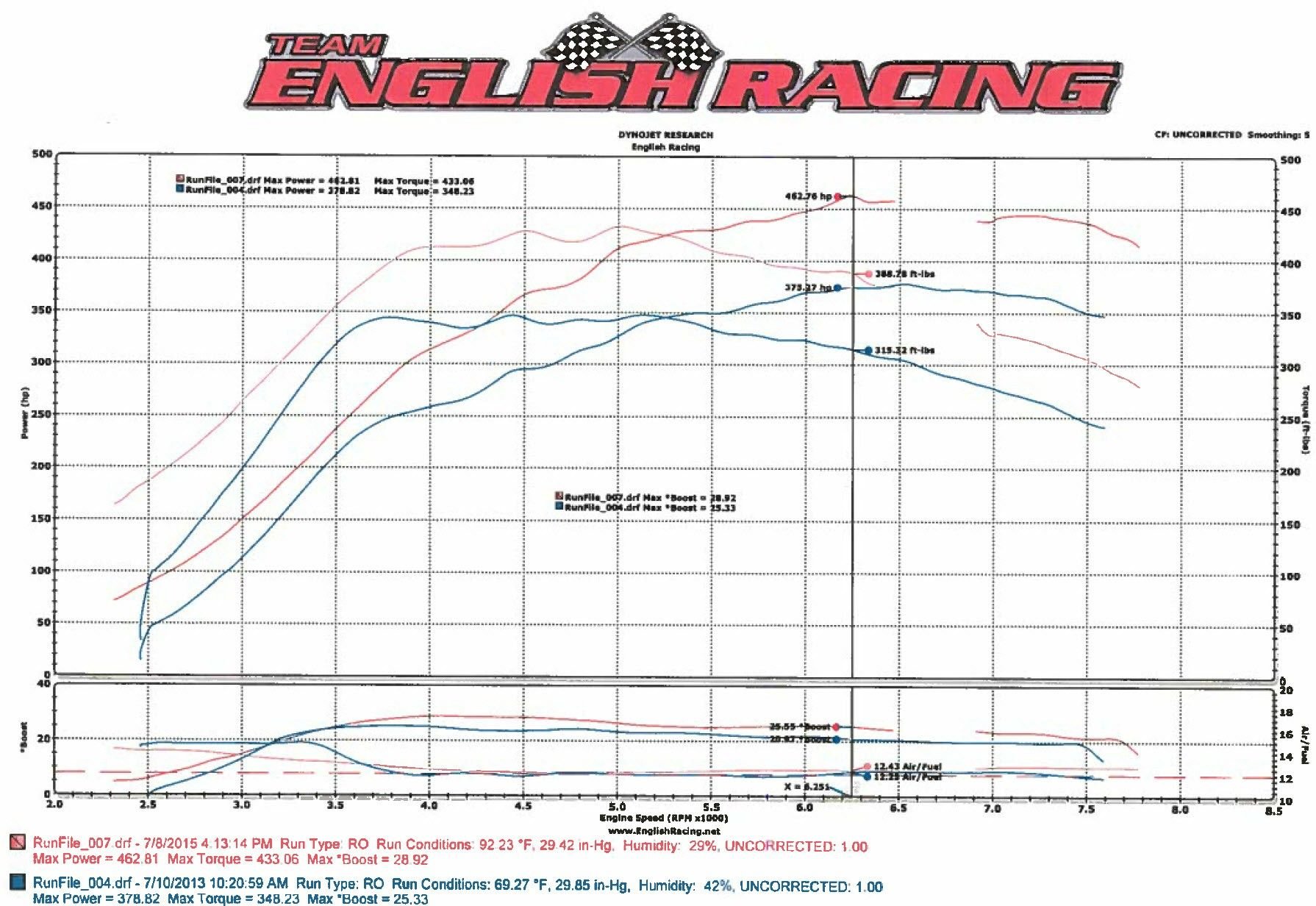

Originally Posted by Dallas J
With the 2.3 and this turbo, response felt pretty much instant. I had some issues with hesitation due to (I think) way to small of a spark plug gap. But when it was pulling, its ripped! So much so, that I have to get use to it so I can think about how its responding. So far though, and as you can see from the plot, the car just pulled from earlier and pulls longer. Exactly what I wanted.
Did I miss the link to the 2.3 dyno chart?

that plot curve looks fun for ax/street use/track duty
