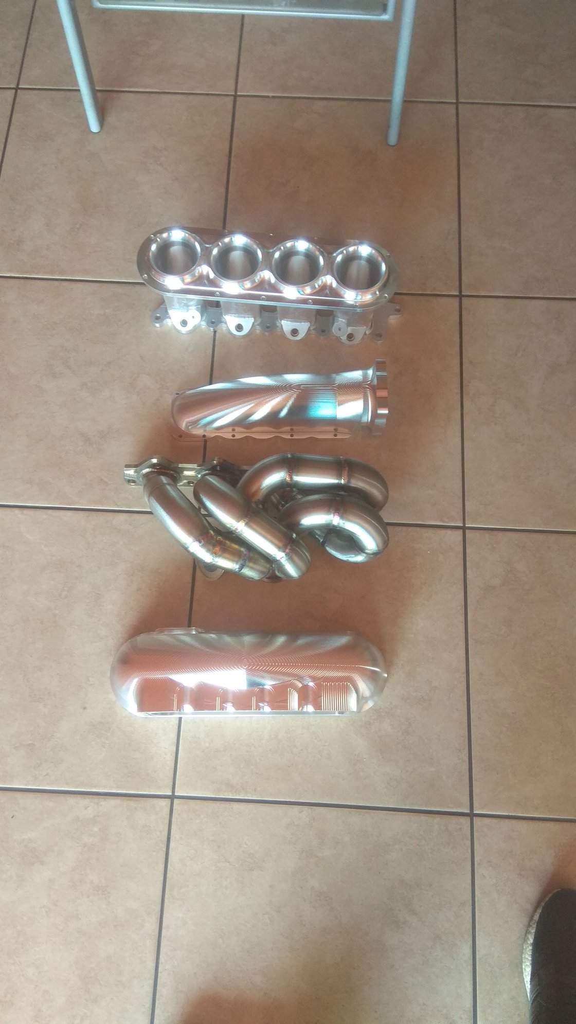

Below some photos of the intake manifold and the header.
Both are top stuff really.
​​​​​​Fabricated from a Greek tuner named Kakarakis. You will be impressed if you check his fb site.
​​​​I was very skeptical before purchasing an intake as I didn't want to sacrifice spool up at all.
This thing really works and makes also a deep induction noise like Weber carburator....

That looks very well designed. Do you know the total plenum volume?
It should be close to 5.5lt.
The runners are quite long and have the shape of venture. I think that helps a lot.
I know that there have been extensive discussions about intake plenums... I was very skeptical too.
This intake is not cheap but really works well allowing the engine to breath property, just my two cents

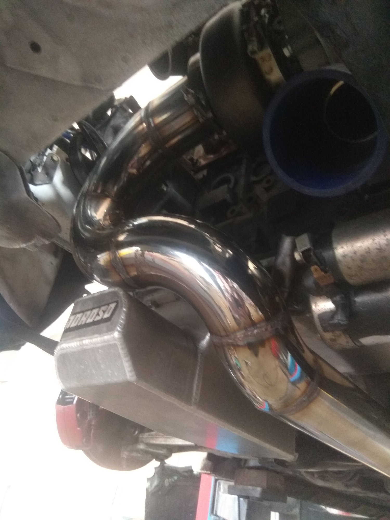

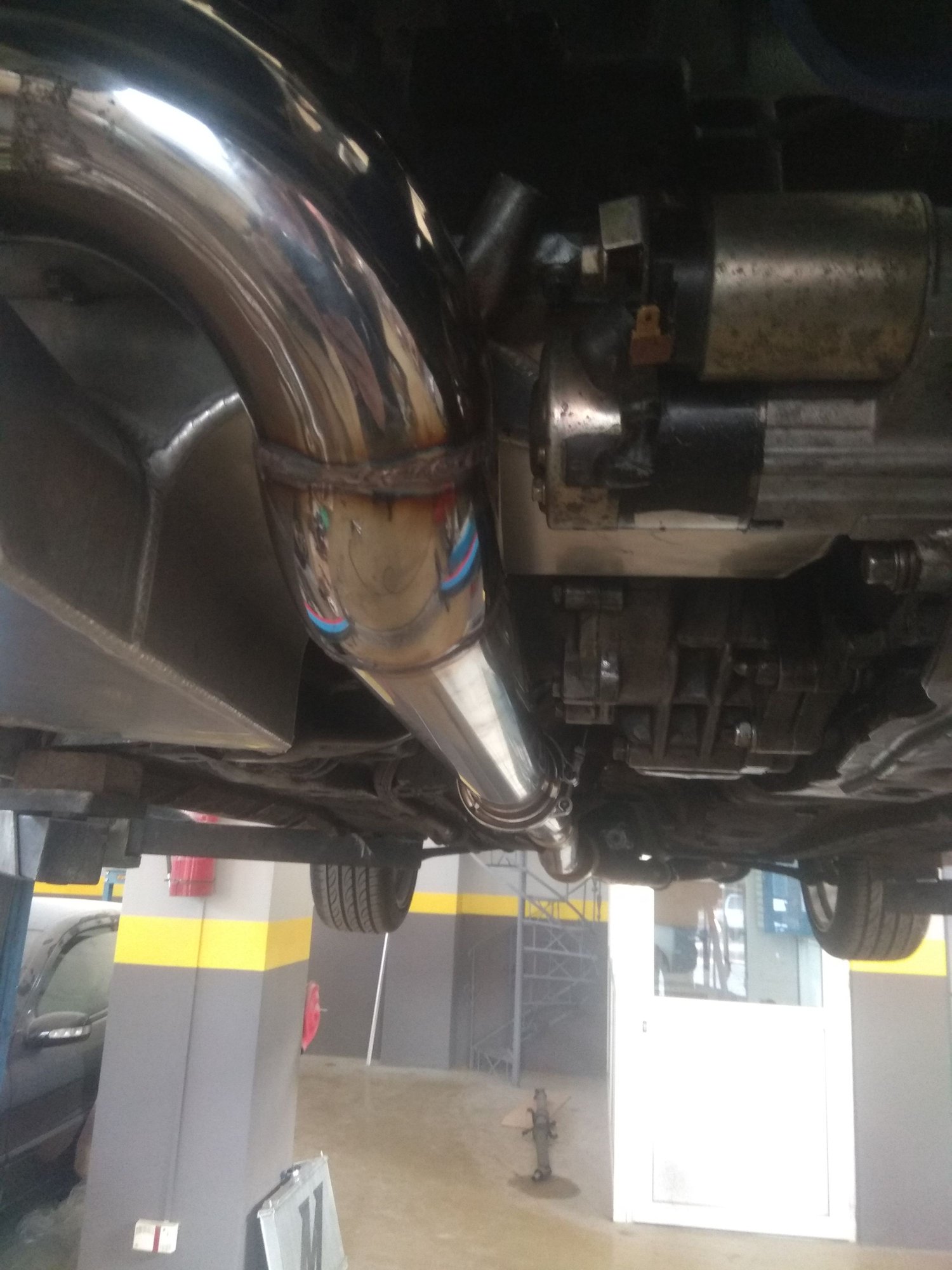

I've seen testing and discussed it with people that have tested it. 3 to 3.5 at 850-900whp was 2psi difference in the down pipe (5psi vs 7psi), and did not help power. It helps to have a 3.5" cat back though, but I think thats because of the muffler causing turbulence more so than the exhaust tubing being an issue.
You want me to show you 3.5 isn't needed. But can you show me that it is needed? Can you prove your statement that it is indeed inferior? Because the testing I've seen doesn't show that.
Additionally the outlet of the Gseries isn't 3.5", it uses a 3.5" vband clamp/flange, which means the OD of the flange is approximately 3.5". The ID however is 3", if not a bit smaller.
I agree with you letsgetthisdone.
In my case we used a down pipe of 76mm and at the v band clamp at the back we increased it to 80mm.
Hot exhaust gases travel faster near the exist of the turbo as they travel backwards they cool down and having a bigger dia helps
