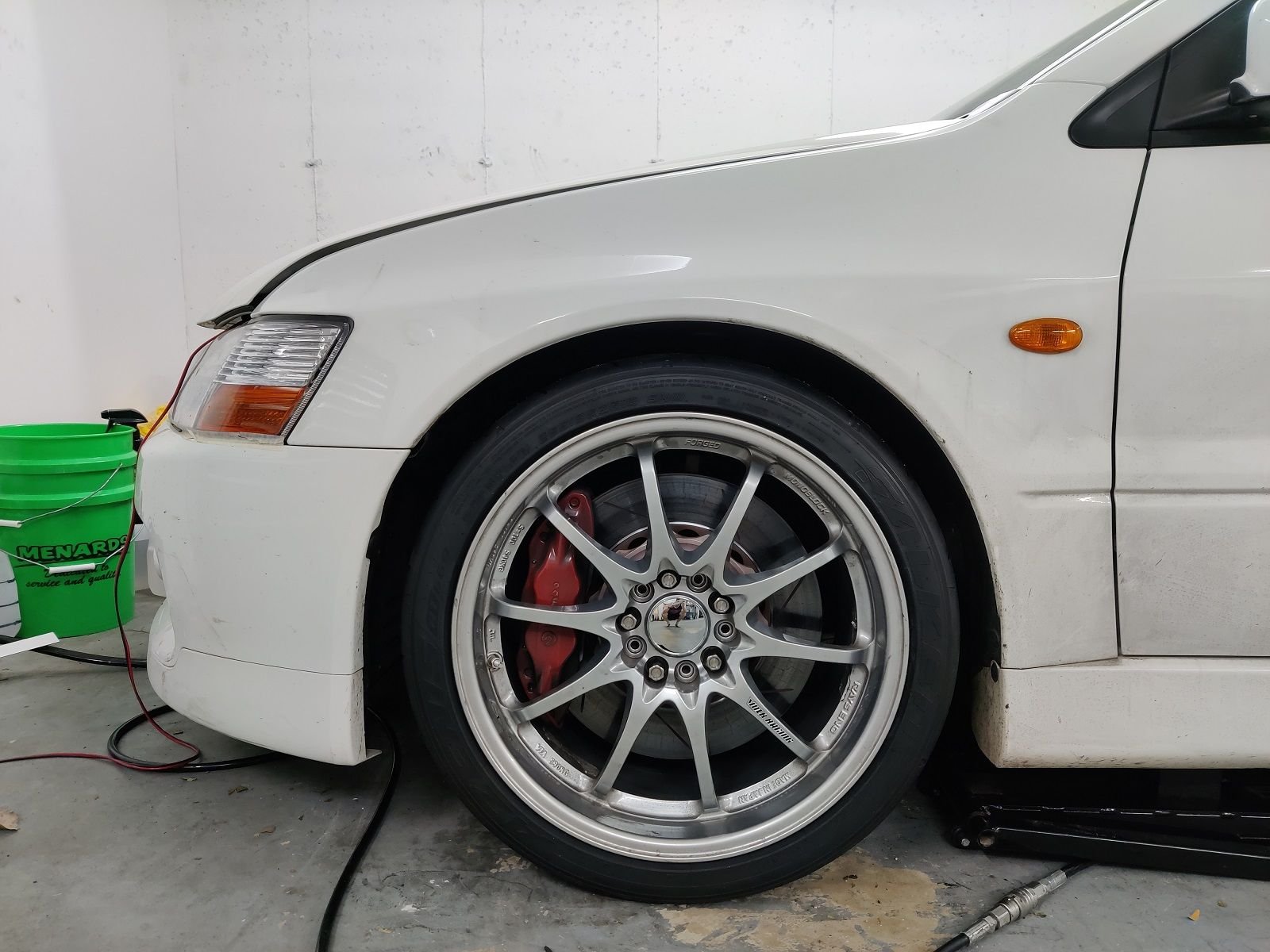

this is why im trying to move as much weight to the rear as possible
this is where my front and rears are, been thinking of raising the front a little. i dont know if the uprights impact any of that, but i think i'm looking to get the street ride height one

You can definitely lower the rear, 0.5-0.75" lower than the front.
so it's more about the differentials, rather than net height? for RC i guess that makes sense
It comes down to the change in roll axis with it steeply angled forward when over lowering the front. Lowering the rear more helps at least get it somewhere more flat-ish. This is cause the RC moves at much different rates front and rear. Roughly 3:1 front and 1:1 rear. Lower both ends 1" and the front drops 3" and the rear drops just as much as the CG. So lowering the rear also has almost no effect on rear roll couple.
that rear is high. I dropped mine to a 13mm rake and the car instantly felt better.
The thing to worry about in the rear is the camber curve ramp rate. It gets steeper and steeper which leads to unpredictability once you start sliding.
Actually, I lowered the car as much as I could without the control arms being in a bad way. Then I adjusted to the 13mm.
thanks guys. i will probably do some kind of combo of dropping the rear and raising the front. i don't know if it's immediately apparent but i take it my level warrants the 1.25" correction length, not the 2" correction length?
