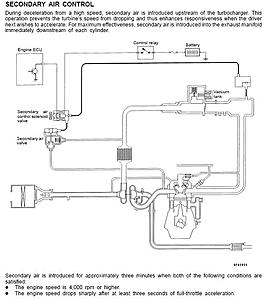

Be carefull on that... I am not sure how to do it correctly, have you read in this thread, how other succeeded to wire SAS solenoid?

two options for pin
run a wire from the solenoid directly to the ecu and pin it (need a pin)
OR
disconnect wastegate solenoid (underneath airbox) and cut the green/turquoise wire.
move wastegate pin (41 on evo 9) to the SAS pin location
I used an injector clip. I grounded one side
connected other to turquoise wire
Old Jun 17, 2009 | 02:25 PM

I grounded one and connected the other to wastegate torquoise wire.
you just need to make sure the ground one is touching metal which is touching the chassis.
I cant remember what side I grounded though (eek) maybe I was lucky the first time.

I always thought, that one wire should be connected to 12v (+), and another (-) to ECU
