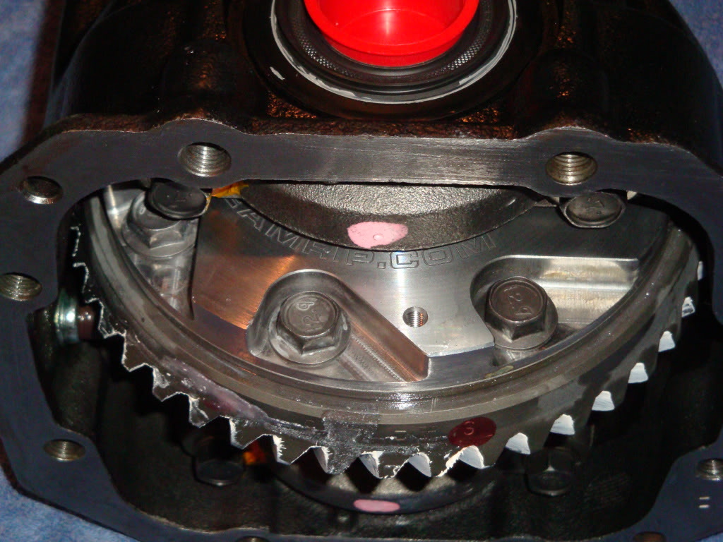

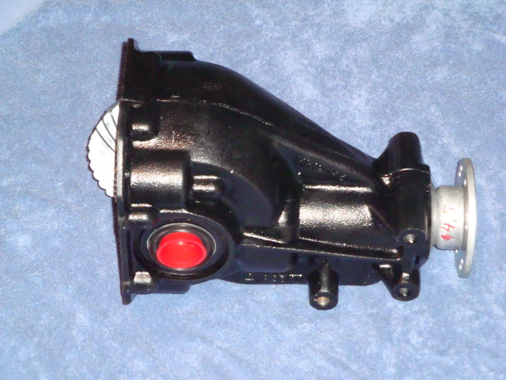

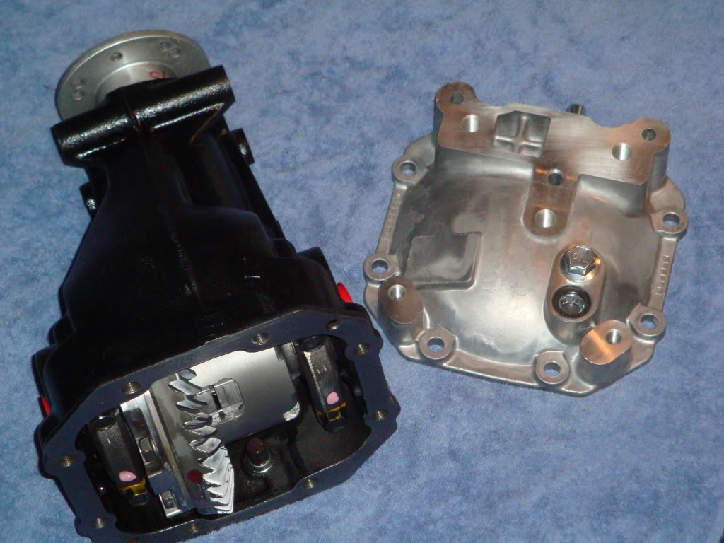

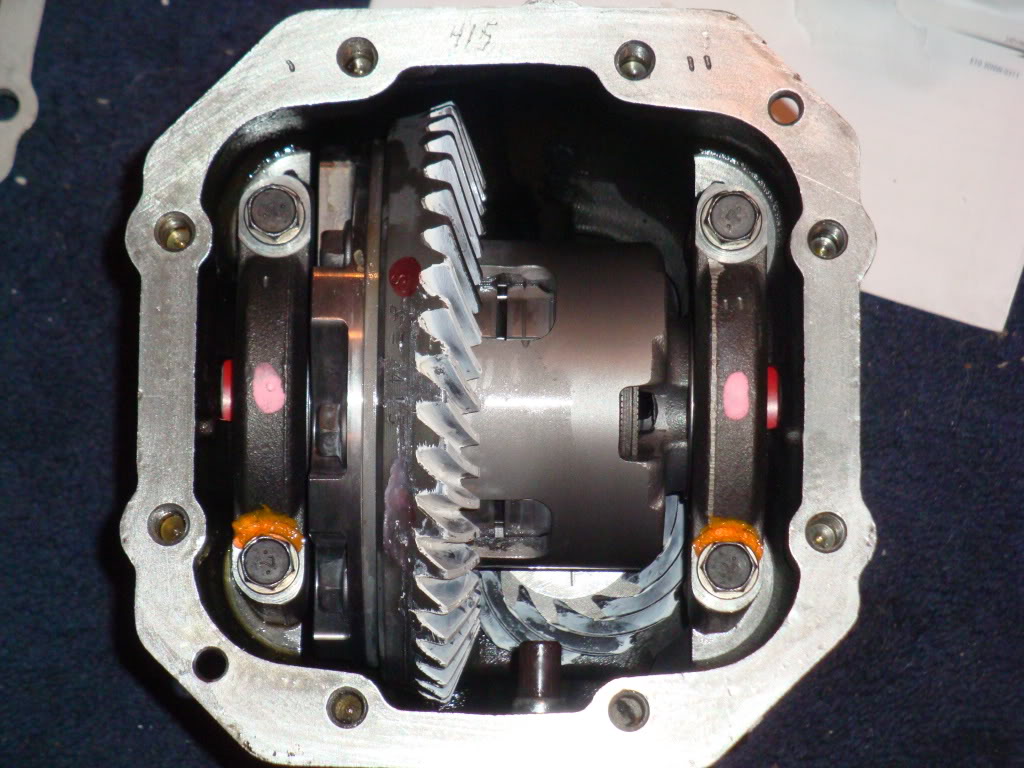

TRE rear has arrived. here she is.

^ Teh hotness!

I spent the day at TRE. I have been there 4 times. Jon built my diff today (looks like the pics above) He is always thinking on how to make our EVO's work and perform better. Jon has some more parts he is working on like the side cover that will be better then the factory stuff. He is in the man when it comes to the driveline!
