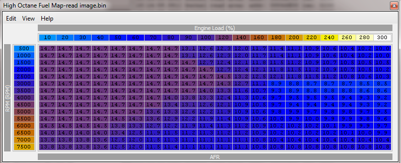

This is My current ROM when I had the Forge DV.
My bov is prematurely blowing off on 2nd and 3rd gear at times. do I need to have it retuned?
