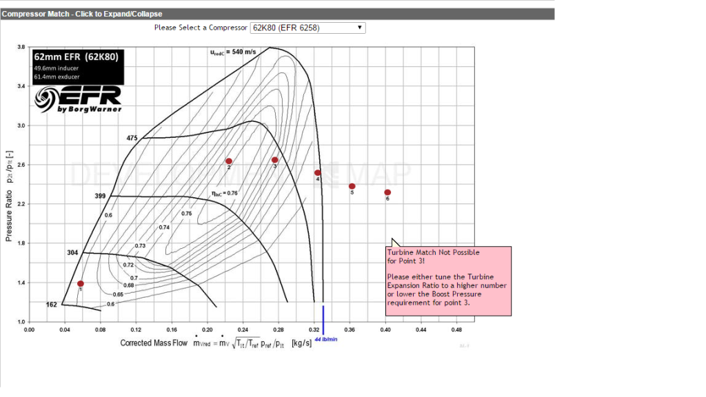

Just because you raise the rpm to 7100 on the stock k16, it doesn't mean you should Matchbot the 6258 which is flow wise basically a 7 blade k16 in the TTRS with a bigger turbine and A/R.
That should explain why you have to dump massive amounts of fuel and timing to rev to 7100. Hell of a testament to the CHRA and bearing system in the BW JB turbo though!
I cut the party at 6800 because frankly, if you can't be fast on track with 3500 rpm of over 450wtq in a 3300lb car on 275s, you don't belong behind the wheel of a car. It could torque drop to 7500, but it isn't like TTRS syncros are fond of shifting at 5000 rpm, much less 7500.
7163 is a little beast. It has virtually the same corrected turbine flow on a .80 AR 63mm turbine of a 68mm 35r turbine in a .63 AR. The compressor isn't but 1 mm smaller than the GTX3576r. Transient response is hands down faster on the 7163 vs the GTX3576r on a .63 or gtx3076r on either housing. The 7163 feels like a stock turbo. It's map is suited for low boost, high flow systems. The surge line would not support 35psi from the word go on a 2.5L, nor would it be efficient anywhere. This turbo works really well on flow heads at lower pressures. Just part of the design of a 6x6 design on a low trim.
