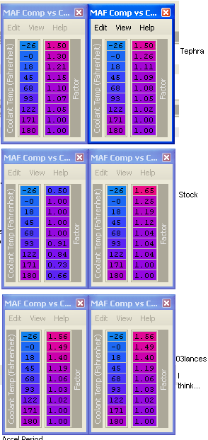

I gave up on the 399 MAF today. I've tried various things, stock lancer scaling+comp, evo scaling+comp, 501 scaling+comp, evo stuff but reducing idle hz comp.......nothing seems to work. The results I see are basically with stock evo settings everything is perfect except the car idles at 10-12AFR WHEN WARM...when cold, it idles 14.7. If i reduce Comp enough to make the car sit somewhere near 14.7, it still oscilates between 13-17, much wider and uglier idling than the lancer maf.
Anyhow, the old dude is back on the car, because I just am not having any luck getting it to run right. I even spent some time the other day talking to RoadSpike, and although some of the things he said made sense.....in the end, it still idles like **** with the 399 in there. The reason I don't think adjusting scaling or comp will be the solution for me and a 399 maf is because i see the same sort of stuff i saw on the base lancer rom, where afr's swing drastically....it just doesn't feel exactly right. Anyhow, probably selling the 399, saving for a omni map sensor, then a gm iat sensor, and then I might try my hand at speed density.....for now though, I'm focusing on getting a good solid 8psi tune as is. Oh, and adjusting the injector scaling did bring my trims down to a more acceptable range, it wasn't related to the 399 maf ...they just were off, but it's fixed now.

WHOA!!!! hold the phone. I just realized something. You've got the evo MAF as well, and you're rich at idle. I thought it was your injectors or something, but then!!!!! I made a discovery.
So, the car runs fine at idle when cold, and the warmer it gets, the richer it gets. Anyhow, there is this table I was looking at, and I bet it could be the solution. I'll stick a pic up....anyhow, there are slight differences...who thinks what?

You know whats weird is I too have this problem BUT, it did not start until after I went forced open loop. Before that I have always had fluctuating afrs at idle but nothing with a pattern like now with the richer at warm idle. I tried early on in my tuning to tune out the fluctuating afrs but eventually gave up on it since near I could tell was not hurting anything, however now with this distinct pattern it really is annoying and I am almost positive it is what caused my egr valve to build up enough gunk to set the DTC. I might try adjusting that table andd see what I get.
I'm trying the same. Even with the stock lancer MAF, I still get fluctuations...they just aren't as "crazy" as with the EVO MAF. I may stick the numbers in the middle one into my car, and see how it runs with the stock MAF. IF it works, then I'll try the EVO again, but I bet the first is low octane and the second is higher octane....so I'll use the first in both of mine, since the lancer rom just seems to be really wonky when it comes to low/high octane, you know. Anyhow, yeah, I see the pattern as well...and this might be a relativly easy fix if it's as easy as copying lancer values in.
I think compensation and the compensation vs temp are specific to an engine, like....the same as volumetric efficiency and all that of an intake, so maybe we keep our comp, keep our comp vs temp, but use the size/filter/scaling of the evo MAF...testing will tell though.
