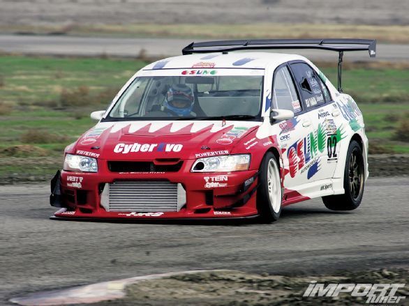

A bit of movement and weight transfer can be good. It worked for these guys
