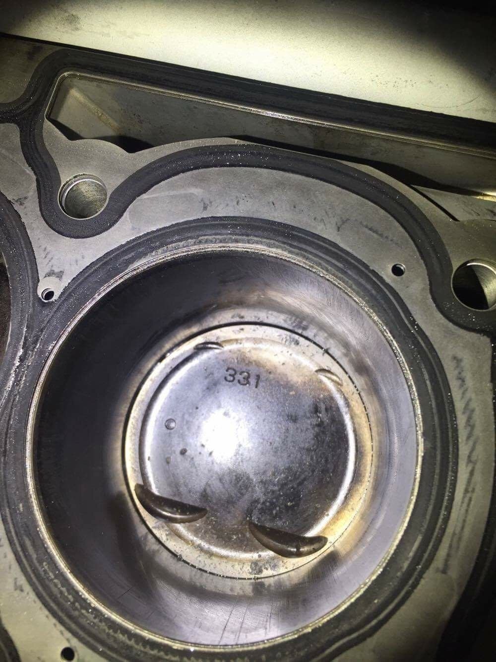

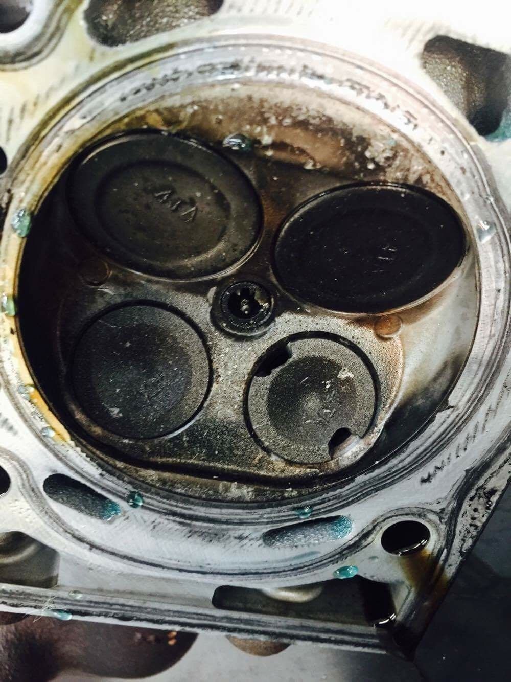

Well, looks like the spark plug shrapnel took out the valve, not the other way around...
Cylinder wall has some damage as well, gets caught on finger nails...

i wouldn't worry, a light bore/hone will probably clear it up.. and if you plan on big power you would need sleeves anyways...
i am actually suprised there isn't more damage with bits of valve clunking around...
Yea I'm assuming they got sucked out the exhaust ports quickly.

Looks like the head and block are both reusable. I still say send the head to ER. If you pm or talk to Aaron, he'll probably tell you how it outflowed a certain company head on said certain company's flow bench. And how it made 100whp over another certain company's head on a high HP setup.
The exhaust ports require A LOT of work on the X head because they're so small.
I'm leaning more towards sleeving the block now which adds even more $$$$ to my planned build so a ported head goes way down the list.
